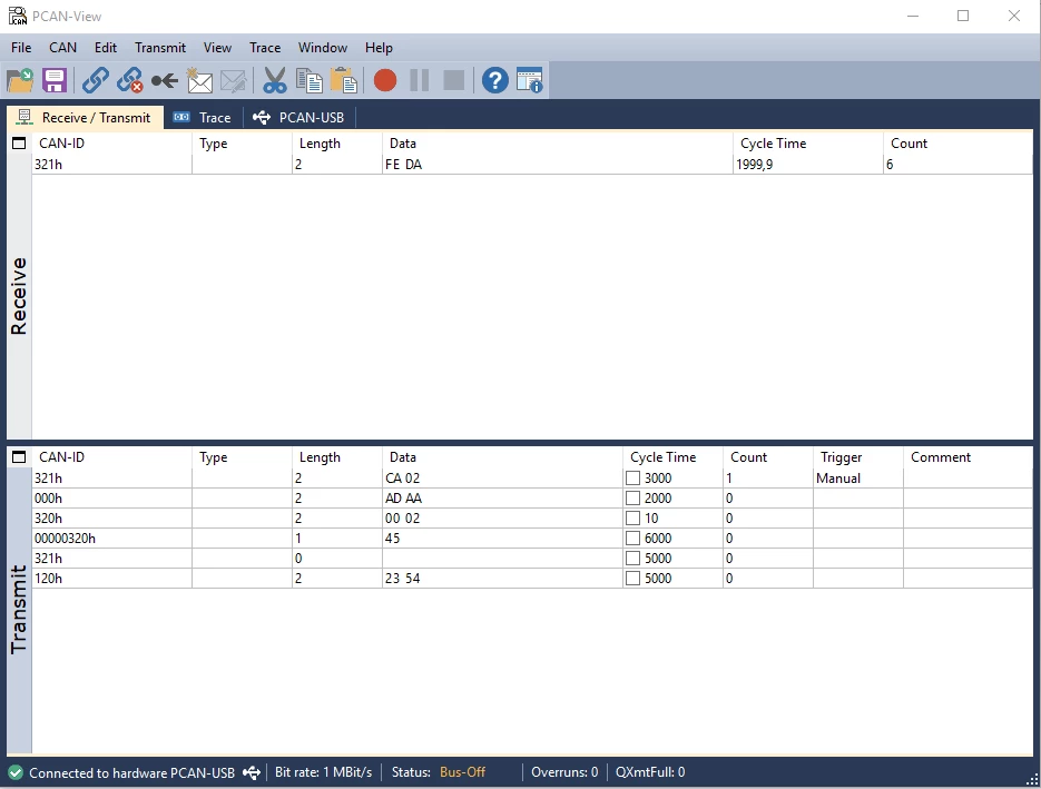

I try to communicate via CAN. I can transmit data to PCAN but i can't receive in Normal Mode. When i use Loopback, i can receive data. Please Help me.. My configuration is here

We use can transciever on board which is SN65HVD233MD.. My can bus speed is 1M/bit. I can transmit but can't receive.. I completely close filter.
When i send message from PCAN-View, my interrupt not triggered and Status is ''Bus-Off''

Your settings are almost certainly NOT 1Mbit/s
What is the APB clock for the CAN peripheral?

hcan1.Init.ABOM = DISABLE;   <- this should be enable to enable bus recovery if a fault is detected.
your filters are enabled but no bits are set.
You have blocked receiving all addresses.

Probably NOT 500k in this case.

You wont be able to receive anything if ABOM is not set.
to enable automatic bus-off management, set the hcan1.Init.ABOM= ENABLE
to be sure, you should disable the filters too:   sFilterConfig1.FilterActivation = DISABLE
to check the final baud rate, transmit something and check the Scope.

It's not complicated, and easier than scoping
CAN Rate = ((APBClock / Prescaler) / (x + y + z))   where the sum is of the bit quanta widths
