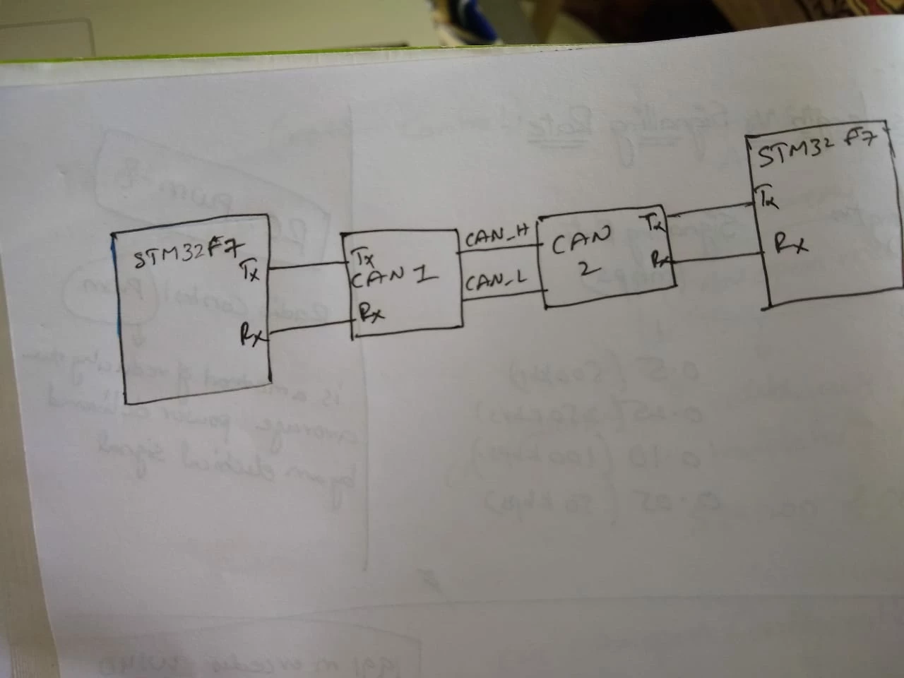

Hi i am using stm32f746zg nucleo board and i want to establish communication between two CAN modules where CAN1 should transmit and CAN2 should receive the msg but its not happening dont know why ..can anyone help me with the code ..?

The filters look okay to me. How are CAN1 and CAN2 connected, with PHYs?
The _1TQ timing look like defaults. Have you calculated it like with http://www.bittiming.can-wiki.info/

CAN1 and CAN2 are connected physically with jumper wires and i am using cjmcu230 canbus module. i changed the bit rate to 100kbps its transmitting perfectly but at reception side it is entering into Error_Handler(); .0693W000001szTLQAY.jpg
KnarfB
July 16, 2020
There is a HAL_CAN_GetError function telling you a bit more about the error. Or: debug-step through HAL_CAN_GetRxMessage
