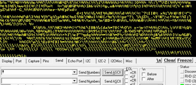

Hi everyone I need help understanding what I am doing wrong. I would like my buffers to work properly, but when I run the program my terminal starts sending all sorts of strange characters. I use stm32f411e-Disco

KK.3
KK.3Author
March 16, 2021
So what should I write instead of this "if(UART_IT_RXNE !=RESET){" and this " if(UART_IT_TXE !=RESET){" ???
when I add in while this :
________________________________
While(1)
char downloaded;
uart_get_char(&downloaded);
if(downloaded == '!' ){
   uart_put_string("abcdefxxxxxxxxxx");
_____________________________________
I send twenty times '!' (because my buf has 20 size and then I received this(picture below). When I removed this:
//void USART1_IRQHandler( void ) {
   //HAL_UART_IRQHandler(&huart1);
and insert this:
void HAL_UART_RxCpltCallback(UART_HandleTypeDef *huart) {
nothing was displayed.
