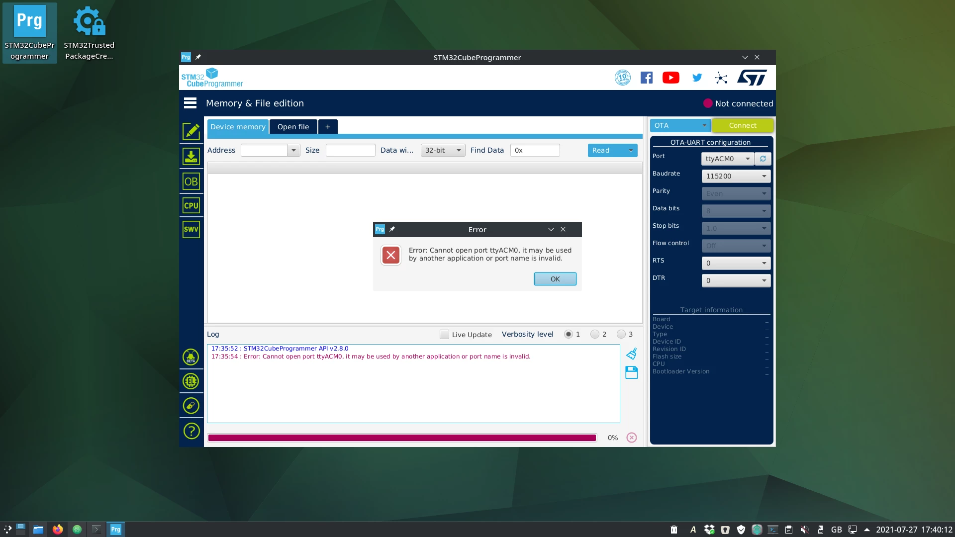

Hi, do any of you know how to achieve the advertised MHz ADC sampling rates on the Arduino H7 Portenta board, which I believe has STM32 H7?
  • July 27, 2021
  • 8 replies
  • 3621 views
I tried the STM32Cube Programmer but it could not connect to the board. I'm on Linux Manjaro. Many thanks

What exactly did the error message say? You can share a screenshot to better understand your issue.
Make sure to use the latest release of STM32CubeProgrammer V2.8.0.

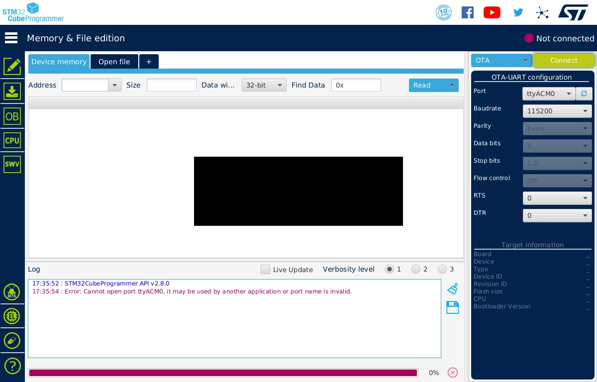

Yes, I can confirm I have STM32CubeProgrammer V2.8.0.
The error is "Error: Cannot open port ttyACM0, it may be used by another application or port name is invalid." I attach a screenshot.
I rebooted my PC and made sure the Arduino IDE didn't hog the port ttyACM0. I've used this port to upload sketches from Arduino IDE and to forward serial comms with socat, so I know it works. The system can see the port:
[ulf@ulf-manj ~]$ ls /dev | grep ACM
ttyACM0
I tried all the four ways to connect, but with the same error message. If you believe that the Portenta H7 board should work with for instance kubuntu 20.04 or even Windows 10, I could give this a go too.

.. better screenshot, sorry grabbed the wrong file

Further to the above, I managed to get rid of that error message by running the Cube CLI as super user:
normal user:
[ulf@ulf-manj bin]$ ./STM32_Programmer_CLI --connect port=ttyACM0 P=NONE br=9600
 STM32CubeProgrammer v2.8.0
sudo:
[ulf@ulf-manj bin]$ sudo ./STM32_Programmer_CLI --connect port=ttyACM0 P=NONE br=9600
Serial Port ttyACM0 is successfully opened.
Port configuration: parity = none, baudrate = 9600, data-bit = 8,
 stop-bit = 1.0, flow-control = off
Timeout error occured while waiting for acknowledgement.
I tried parity even, baudrate 115200 too, even --go noack, but the timeout error persists
