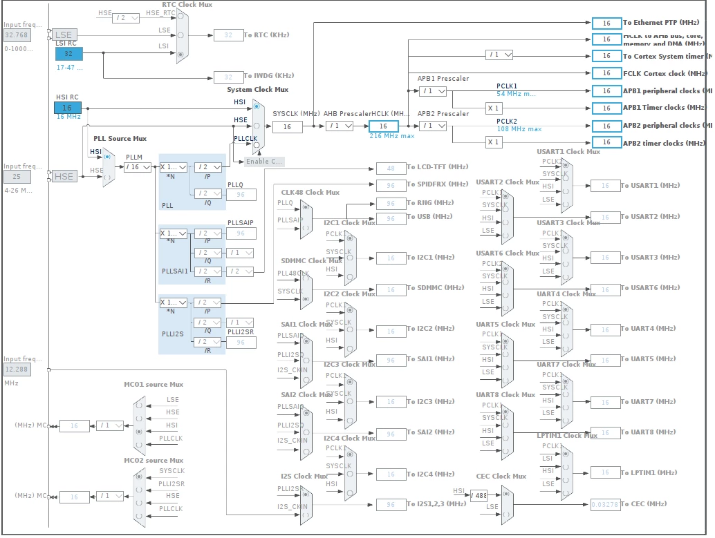

>> And what system clock?
Internal 16 Mhz clock , attached screen shot for the clock configuration.

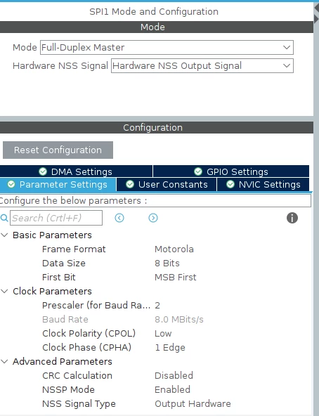

So with my understanding from the above reply .
  1. it is not possible to generate a 24 bit of data through the SPI IP ( Attached IP setting) and require to write own SPI logic ?

Sending 3 8-bit bytes adds up to 24 bits. There is no functional difference between a single 24-bit write and 3x8-bit writes.
The F7 has a 32-bit TXFIFO which can buffer the 3 bytes immediately without having to wait for data to be shifted out.
You can use DMA if you want, but it's not necessary.
When sending 3 8 bits, the chip select is asserted for two times ( attached screen shot ) , so my peripheral chip is assuming a different SPI cycle during the assertion of each chip select. That is the problem, I am facing
January 13, 2022
Looks like you're using NSSP mode.
Manage CS as a GPIO output and toggle it manually.
Yes , the screenshot provided is in NSSP mode.

The hardware NSS of SPI in master mode is mostly useless.
One way to make SPI timing more deterministic and avoid "manual" wiggling of NSS is to generate the clock signals using cascaded timers, and connect them externally to SPI set as a slave. Not trivial.
