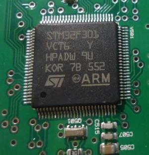

Hi, firends!!! help me to find Datasheet on such STM32F301VCT6--QFP 100  microcontroller, I not where can't find him, I will be very grateful to you, thanks.

    Not much detail on it, will push to moderation, I assume it is a higher FLASH/RAM, perhaps 256K/40K
    http://www.st.com/content/ccc/resource/technical/document/datasheet/29/f7/28/76/14/ff/42/59/DM00093332.pdf/files/DM00093332.pdf/jcr:content/translations/en.DM00093332.pdf

    Hi! thank you for information, but alas it is not such Datasheet, my QFP-100 microcontroller, but your Datasheet is QFP-64 where to me to find on my QFP-100 microcontroller? I will be very grateful to you, thanks.

    I know, the document and the ones for the F302's should give you enough data to at least make some forward progress. I requested other data sheets.
    Ask your board vendor, this seems to be a Chinese market device.

    Thanks - clive1 - now everything became clear to me, I have it seems understood and have found my microcontroller on the Datasheet microcontroller has to be from such STM32F302xC series, thanks to all who helped me.
