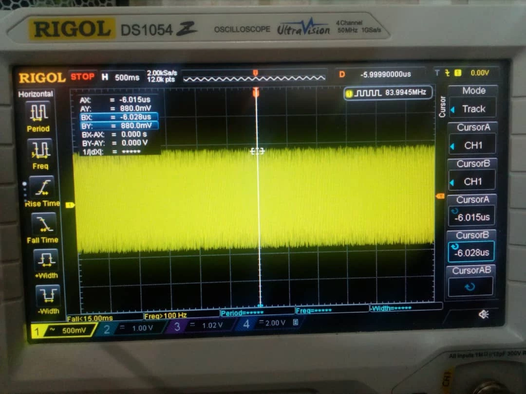

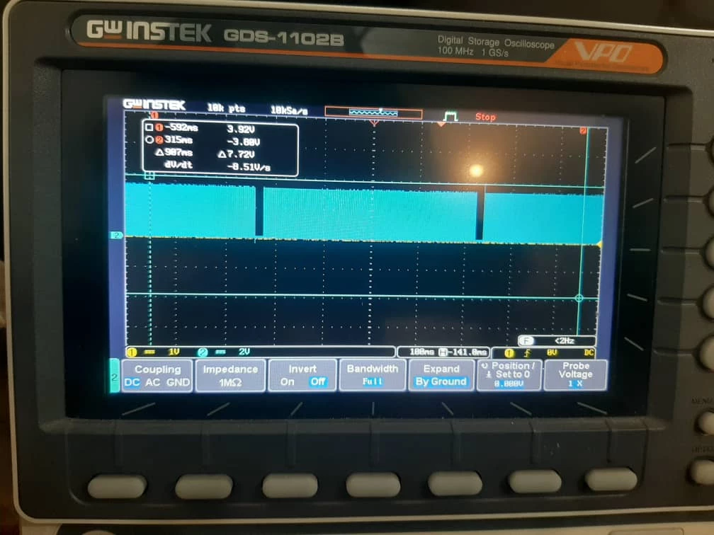

Hello. When I use external crystals, I have a low frequency (2Hz) disturbance on PWM outputs. This disturbance also appear on SWDIO & SWCLK pins. But everything is ok with internal oscillator. The MCU is STM32f401RBT6. Thank you for your help.

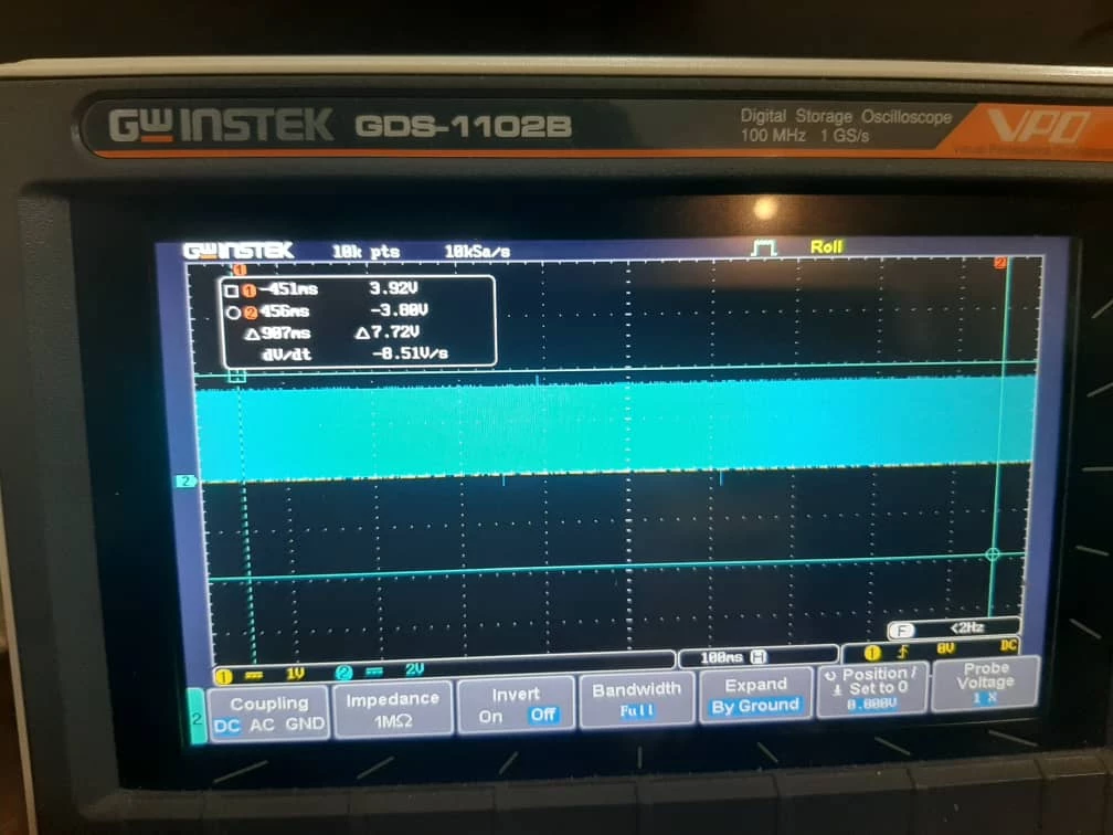

0693W000006EkBvQAK.jpg0693W000006EkBlQAK.jpgThe first image is PWM output when using internal oscillator & The second image is PWM output when using external crystal.

Probably your clock source is getting disrupted. Pipe MCO to an output pin and measure that on the scope along with your PWM signal.
Could also be your chip is getting reset at regular intervals, or timer is getting disabled.
As for why? Hard to say without seeing more information. You can read this for proper selection/wiring of crystals:
https://www.st.com/resource/en/application_note/cd00221665-oscillator-design-guide-for-stm8afals-stm32-mcus-and-mpus-stmicroelectronics.pdf

0693W000006EkyTQAS.jpgThank you for your help. The MCO output is OK.
This image is MCU output.
I also found that the frequency of the disturbance varies with PWM frequency.
For example the frequency of the disturbance is 2 Hz when PWM output frequency is 15000 Hz &
the frequency of the disturbance is 0.5 Hz when PWM output frequency is 3750Hz.

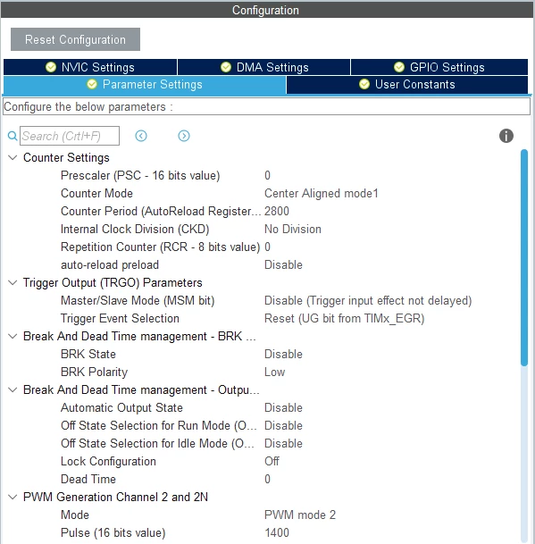

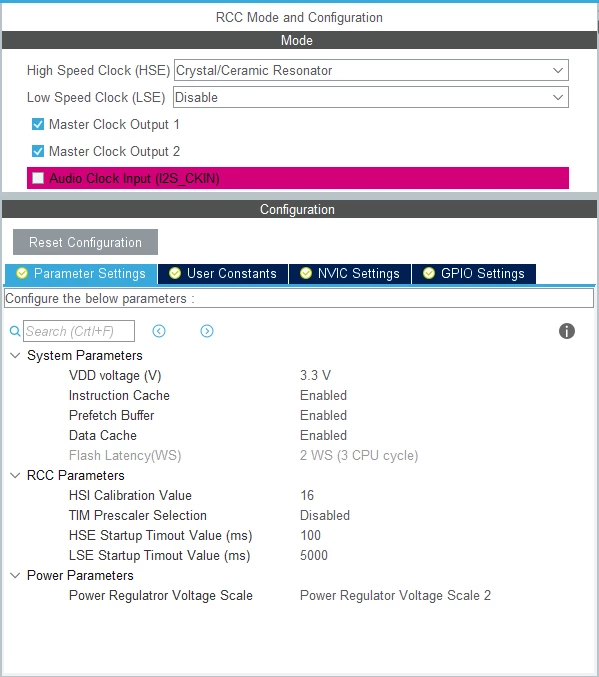

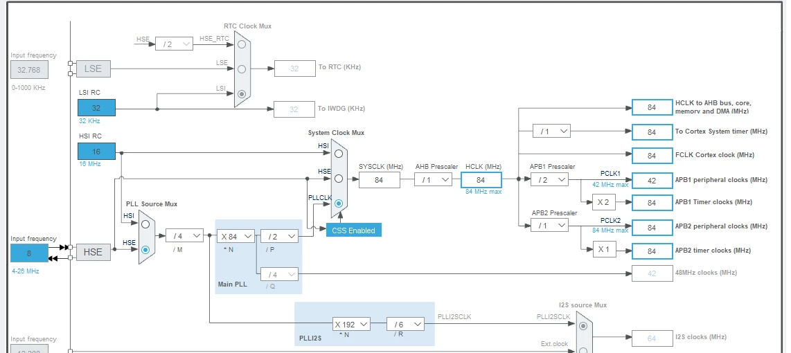

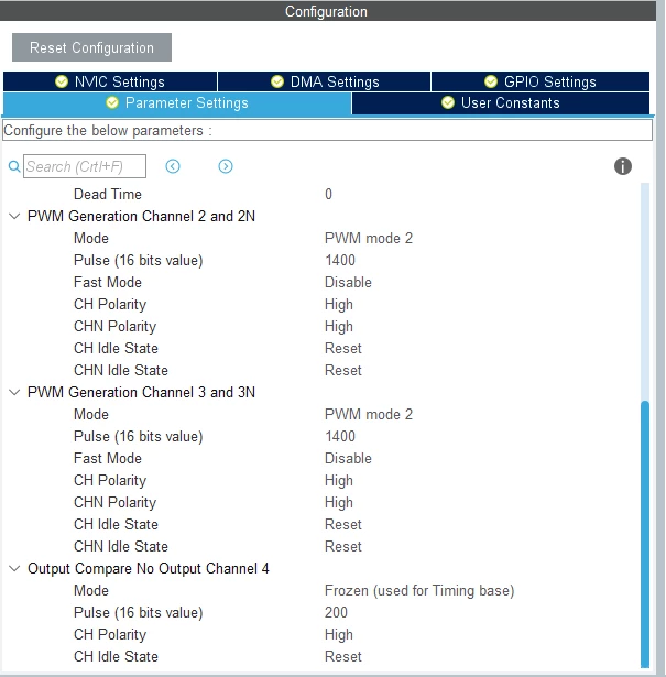

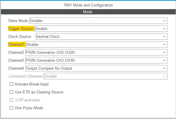

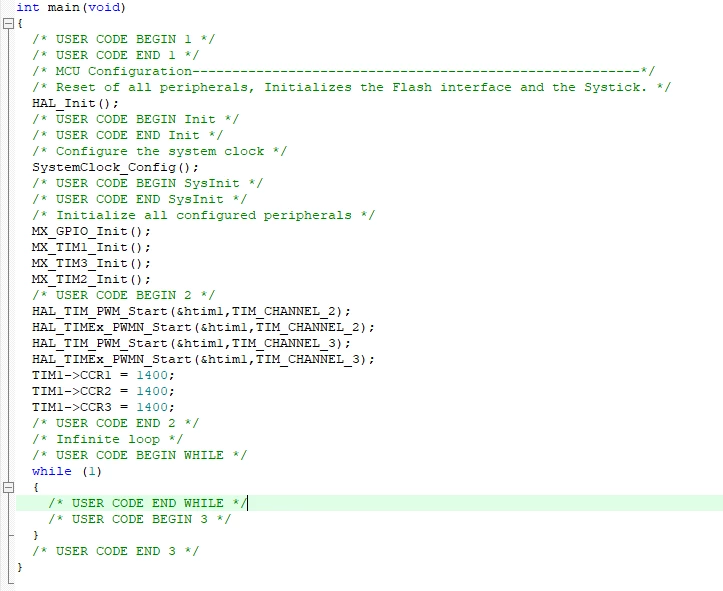

Here you are.
The code is very simple and we don't have any ISR routines. We just have a PWM signal with frequency = 15KHz & Duty cycle = 50%.

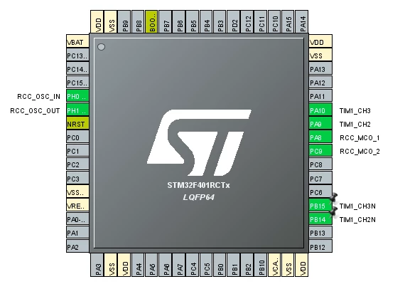

0693W000006EmPfQAK.png0693W000006EmPaQAK.png0693W000006EmPQQA0.png0693W000006EmPLQA0.png0693W000006EmPGQA0.png0693W000006EmPBQA0.png0693W000006EmOwQAK.png

Try to switch off CSS.

Thank you for your attention. I tried that. Nothing was changed.

Try your code on a "known good" hardware such as Nucleo or Disco board.

December 9, 2020
Thanks. I did it. The disturbance was not removed.
I found that when we remove deadtime, The disturbance is removed.
But I need deadtime.

Hello. I found that when the PWM period is an integer multiple of the dead time, The disturbance is removed.
Do you know why this happens?
Do you know anything about this fact?
