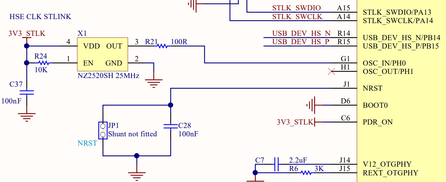

Hello, i want to use an external stable precise clock for measuring with the stm32 instead of the local crystal oszillator.

    0693W00000GY2ooQAD.pngHere is an example link for the HSE oscillator.
    from https://www.st.com/resource/en/schematic_pack/mb1364-h753zi-c01_schematic.pdf
    there are different combinations in the reference designs. you can study reference designs and learn a lot

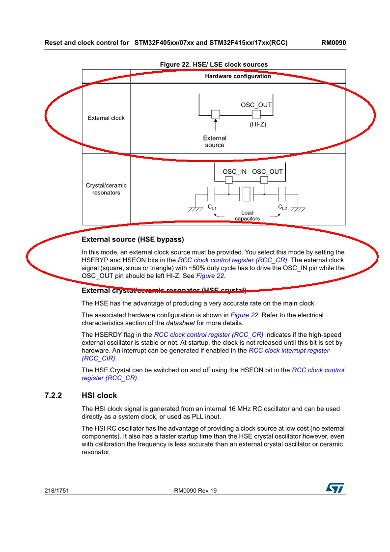

    thank you but i don't want to use a external quarz. Instead of the external quarz, i want to use an external clock source like a Rhubidium reference or an GPS stabilized quarz oszillator. At least a external low voltage TTL clock. For example the AVR controller can be used with an external TTL clock by feeding it into the input pin of the internal inverter for the quarz oszillator, but i did not found any documents for the STM32. I use the STM32F407 for this project.

    Hello Muhammed, thank you very much. That is what i am looking for.

    You can use a clock signal as the input to HSE by putting it in "HSE BYPASS" mode and piping the signal into OSC_IN as in the schematic above.

    Which STM32?
    Details for other STM32 may differ (e.g. whether the OSC_OUT pin may be used as GPIO or not).

    For this project a STM32F407.
    Thank you very much. I have read a lot of the stm32 original documents and contributions from other user published in the www, but i have overseen this.
