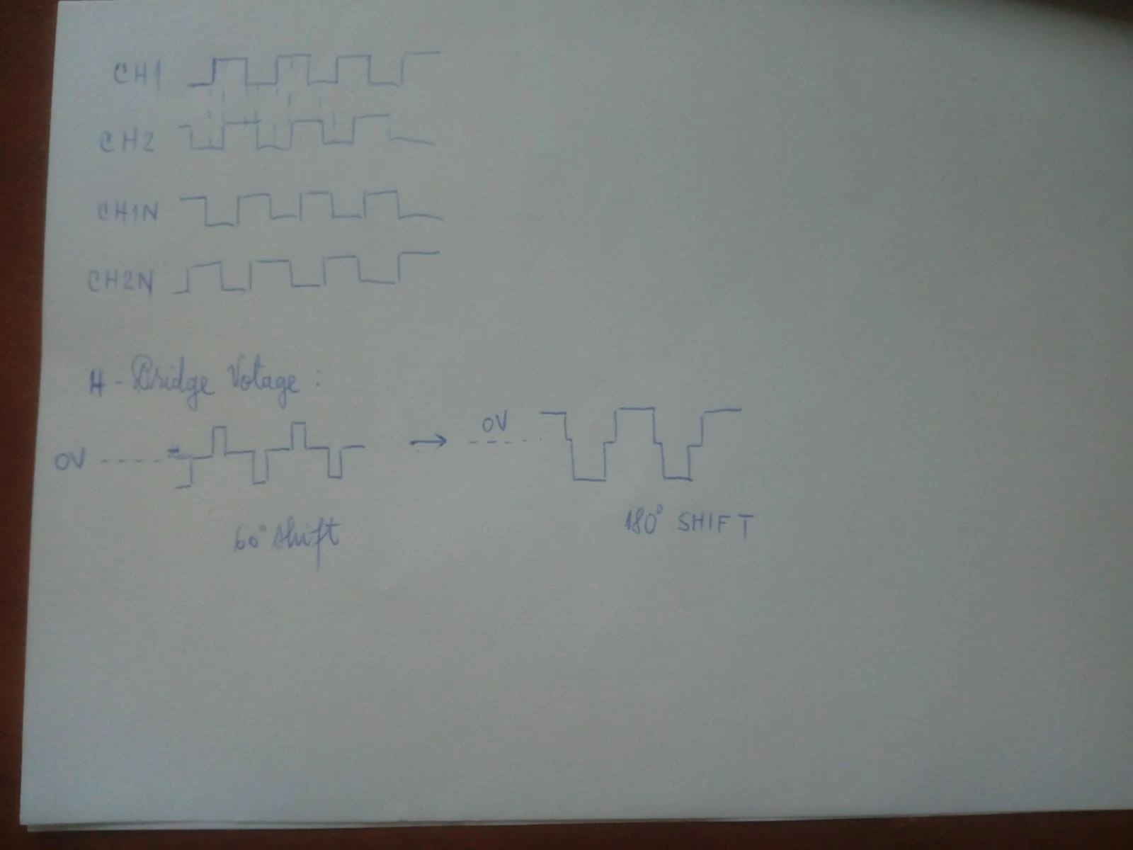

Sorry, that is what I should do:0693W00000BbOmSQAV.jpgThe problem is that the MOSFET gate is connected only at CH1, CH1N, CH2, CH2N. When I projected the system I didn't known that I need soft-start for H bridge.

I want to start from 0 phase shift to 180 phase shift.

OK so just leave CH1 as a plain PWM, and combine CH2's output out of oc2ref and oc5ref by setting TIMx_CCR5.GC5C2, which will cause those two PWMs to be ANDed into CH2's output. Position of one edge is then given by CCR2 and the other by CCR5, so for a pulse of constant length and changing phase against CH1, you must change both simultaneously.
This is probably better tested/learned on a Nucleo board, outputs observed using oscilloscope or LA, than on your live system. CH5 does not have an output, so to get a feeling of what you do, start with CH1 and CH2 to generate overlapping PWM, then switch one of them to the combined AND mode. After initial setup of the timer, the code can run into an infinite loop, while all the experimentation can be done directly by writing to registers in debugger.
