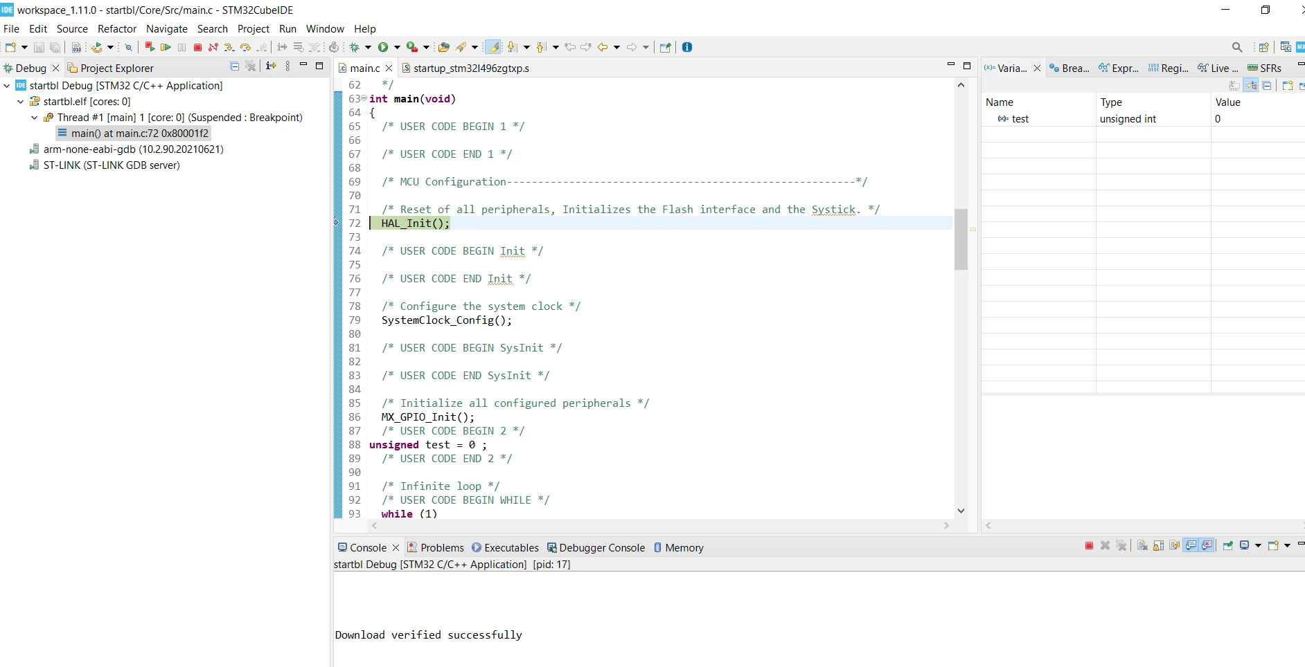

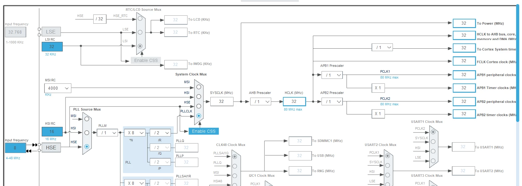

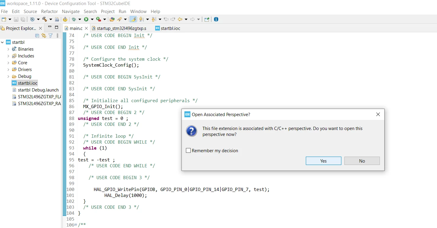

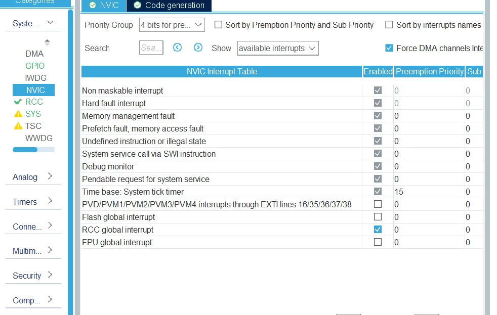

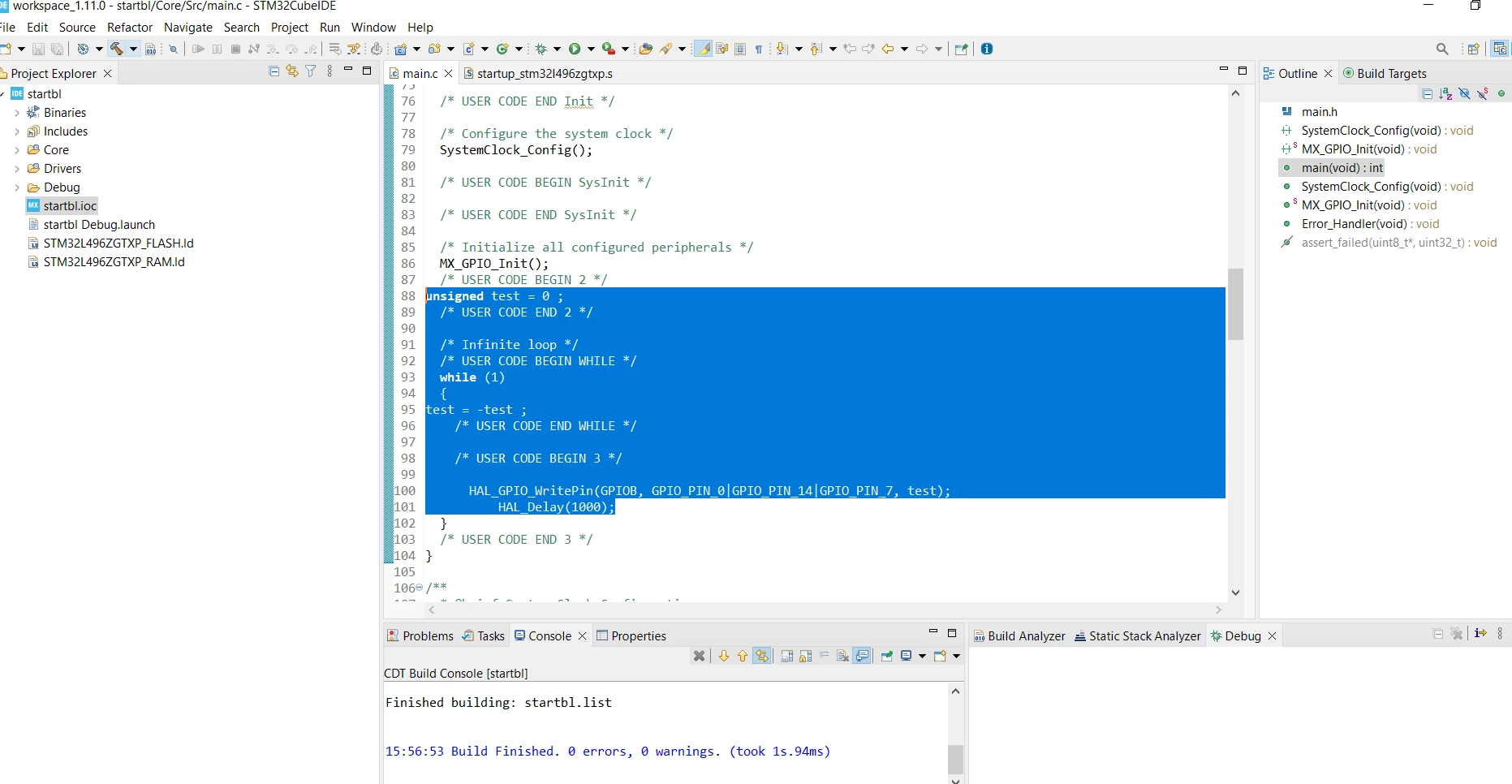

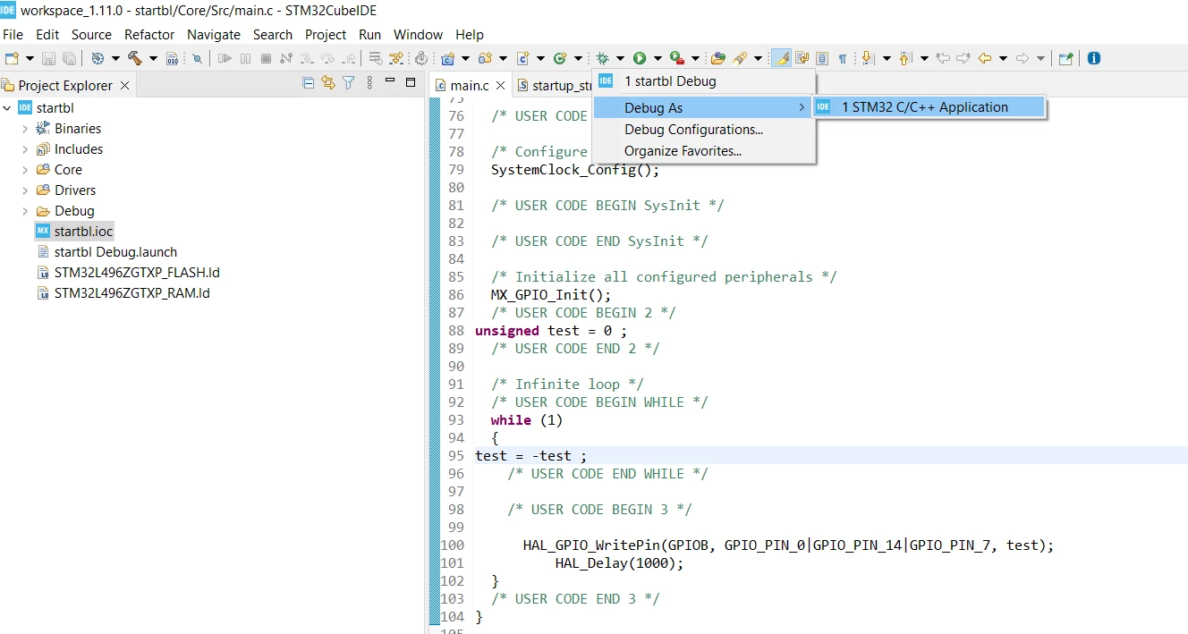

Hello and thanks in advance for any helping , I start learning recently and my first Blinking codes not working , i guess forget any point , please kindly check codes and pictures and recommend me. I add more pic in reply. please check all.
  • January 12, 2023
  • 3 replies
  • 5329 views
stm32cubeide
i set as attached files, save and it generate codes by itself,
then add codes for blinking and then building ,
finally debugging ...
no blinking at all ...

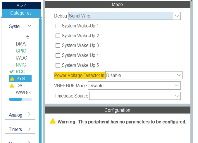

    0693W00000Y839TQAR.png0693W00000Y83AVQAZ.png0693W00000Y83AaQAJ.png0693W00000Y83AfQAJ.png0693W00000Y83ApQAJ.pngI add more images

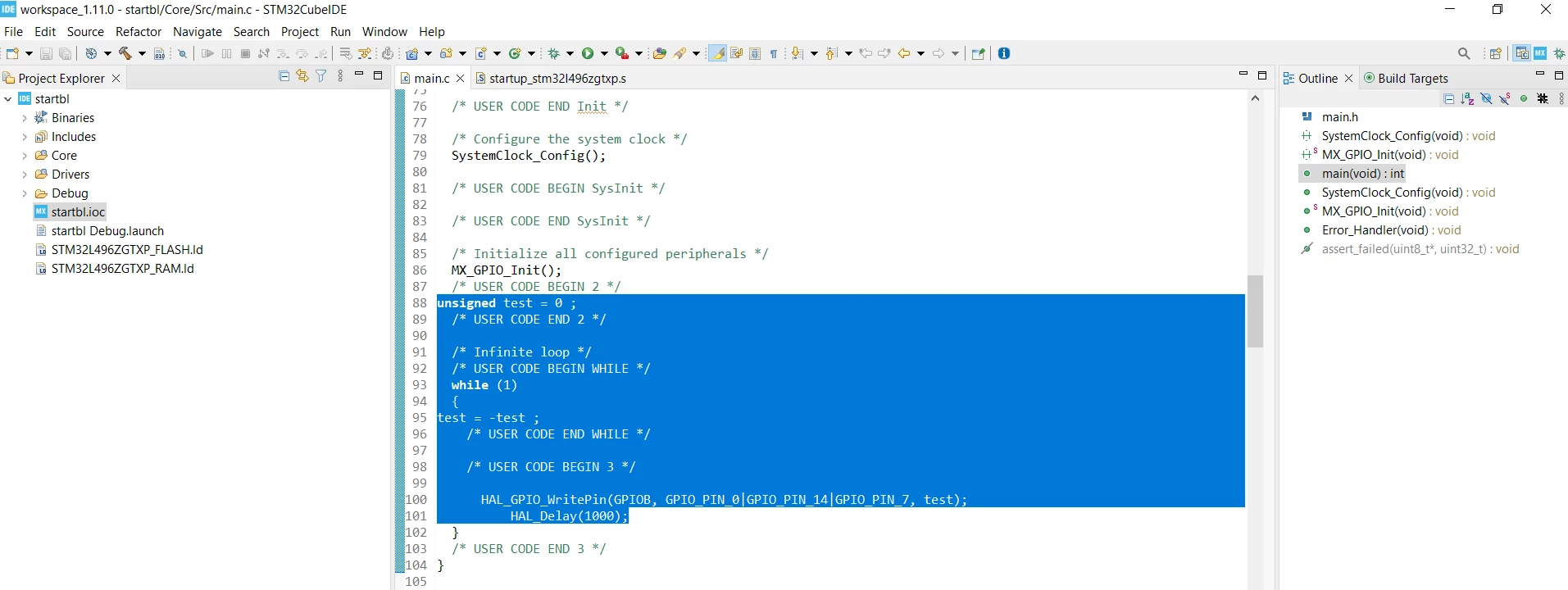

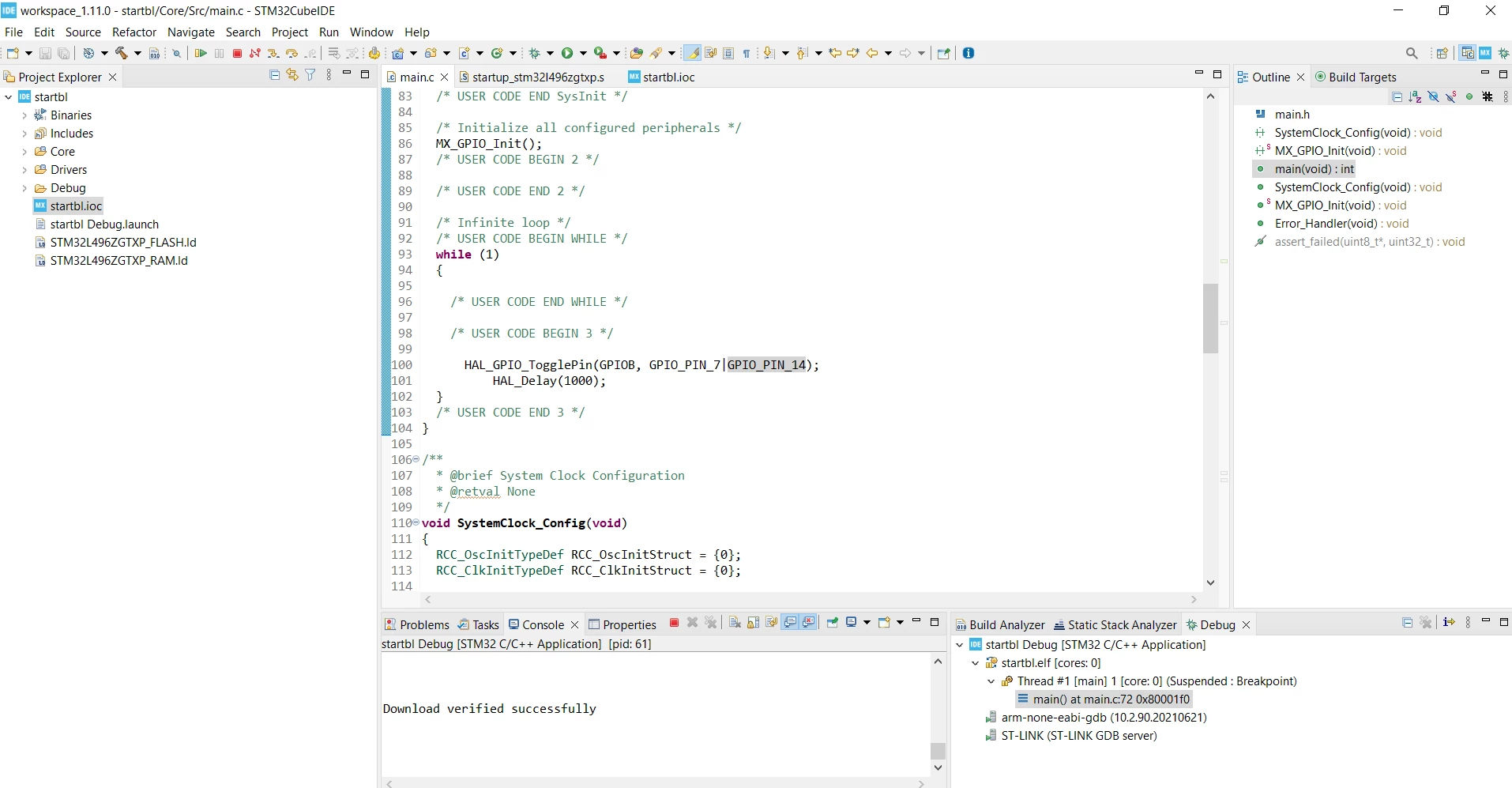

    3rd parameter of HAL_GPIO_WritePin should be GPIO_PIN_RESET or GPIO_PIN_SET (0 or 1)
    If I understand well, you're doing test=0 and then test = -test which is always 0.
    There is another function that might interrest you: HAL_GPIO_TogglePin, please have a look.
    Good luck.

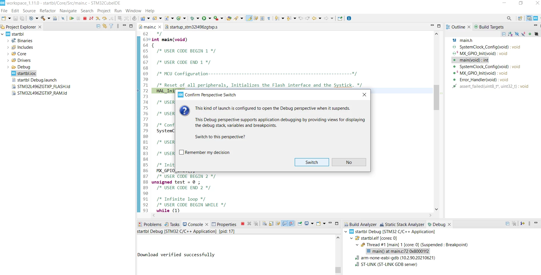

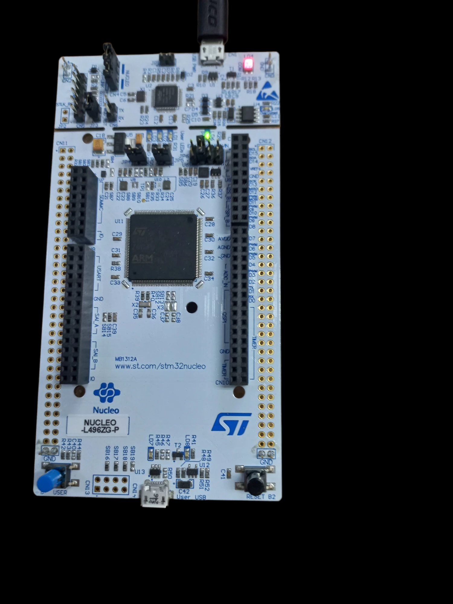

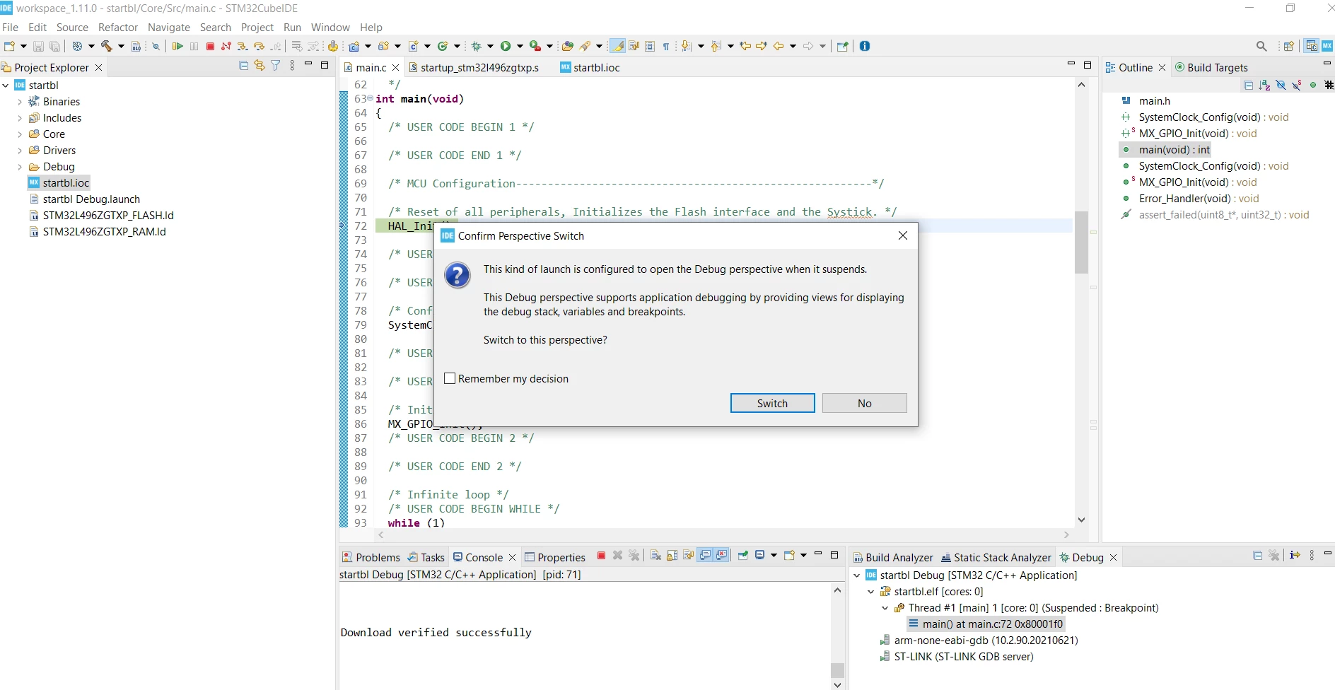

    Dear Mike i did it as attached files ,
    then debug and it continue blinking (red /green...) it means continue uploading?

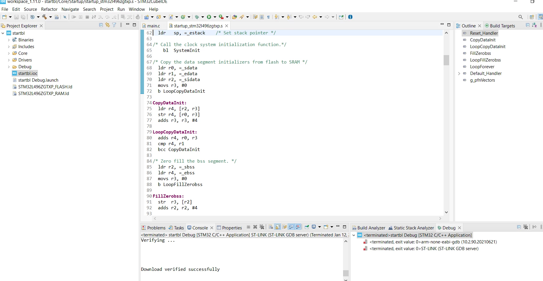

    0693W00000Y83JXQAZ.png0693W00000Y83JcQAJ.pngHow long it take for debugging?
    Am i forget any setting ?

    The LD4 led keeps blinbking RED/GREEN when debugging. That is normal.
    You should be able to go step by step.
