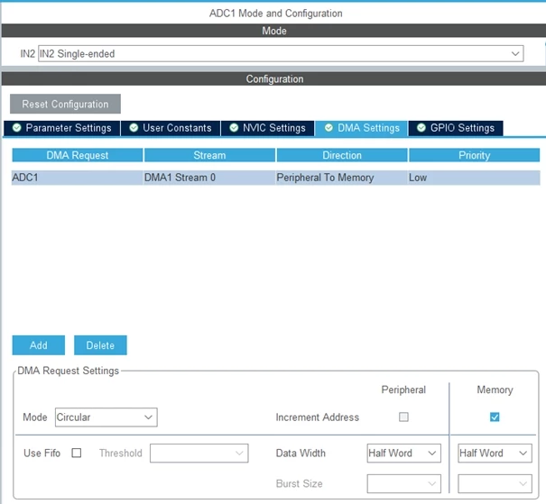

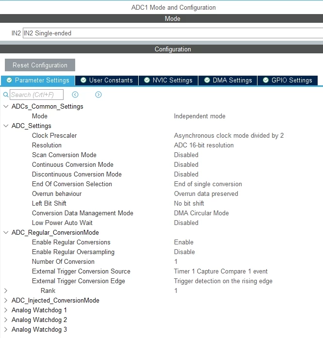

I'm running ADC 1 in DMA mode with data stored in an array variable.
The ADC is triggered by the 5 Capture/Compare Update events from Timer 1.
The DMA is set up to store the data in an array.

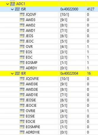

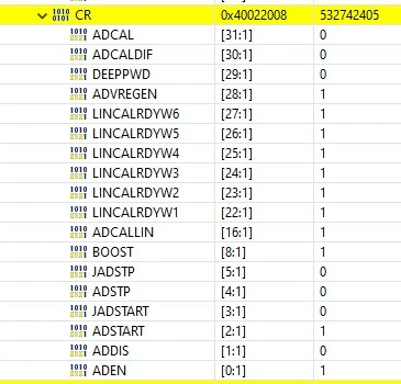

Register ADC1 - DR - RDATA is changing correctly with changing input voltage - showing that data is being produced by the ADC.
This would indicate that the ADC is being triggered properly by Timer 1 - so no need to look at Timer 1 (or timer 3) registers as they seem to be working properly.
Register DMA1 - S0NDTR - NDT has a value of 4 and does not seem to changing.
ADC Registers:
Then check the path from ADC to DMA.
First, read the DMA-related sections of Data management subchapter of ADC chapter. Check the ADC registers if they are set up properly for DMA, and if there's no status blocking further conversion and/or DMA triggering.

ADC1 uses DMA1 Stream 0
It does not appear that any of the required DMA control bits are set to 1.
I don't understand why.

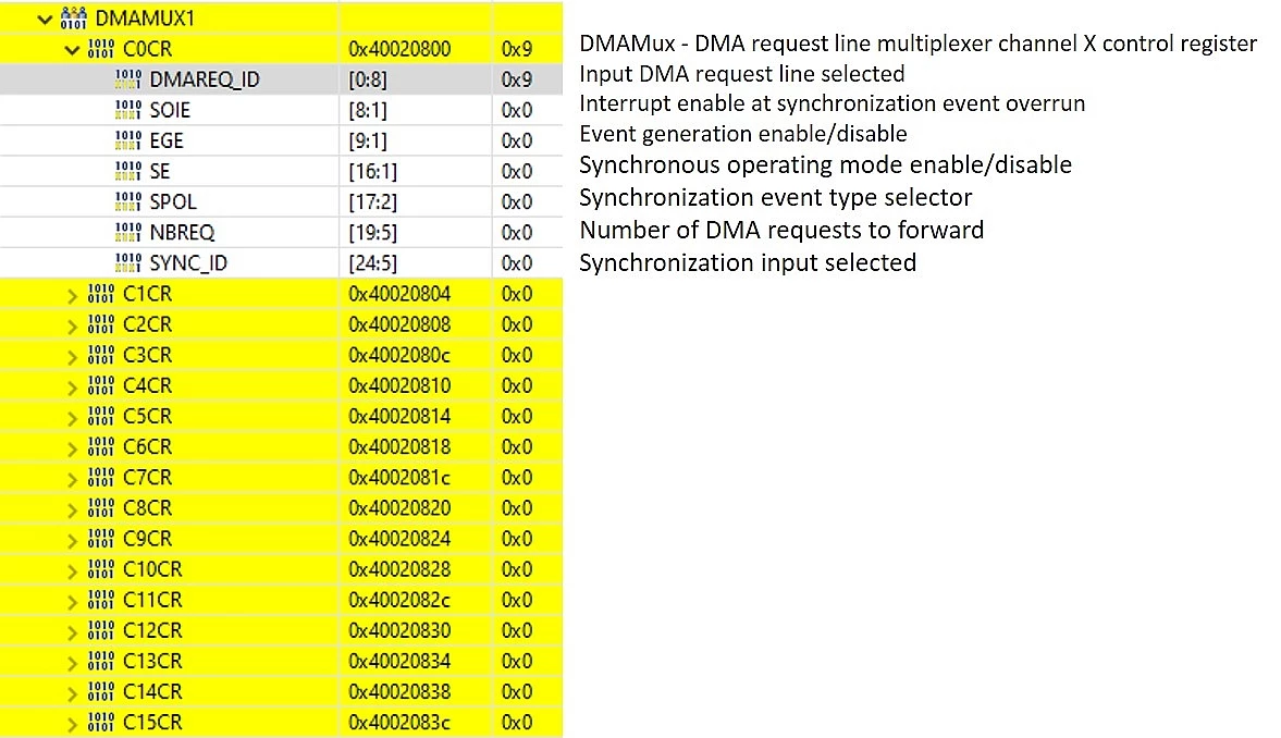

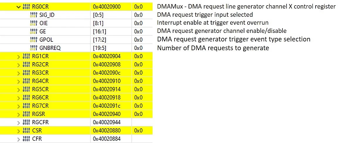

waclawek.jan
April 27, 2021
DMAMUX is a complex machine of which you probably don't use nothing just the plain routing provided by the DMAREQ_ID field, which is filled in - just check if that value corresponds to ADC request, in table at beginning of the DMAMUX chapter.
