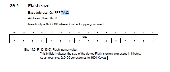

Our design and firmware used to work with former batch but a current lot of STM32F427 does not have a proper readout of the flash size and does not switch from bank A<->B.
The STlink reads the following on a working chip:
STM32 ST-LINK CLI v3.2.0.0
STM32 ST-LINK Command Line Interface
ST-LINK SN : Old ST-LINK firmware/ST-LINK already used
ST-LINK Firmware version : V2J14S3 (Need Update)
Old ST-LINK firmware detected!
Please upgrade it from ST-LINK->'Firmware update' menu.
Connected via SWD.
Target voltage = 3.3 V.
Connection mode : Normal.
Device ID:0x419
Device flash Size : 2048 Kbytes
Device family :STM32F42xxx/F43xxx
0xE0042000 : 19 64 01 20
0x1FFF7A22 : 00 08 AE 4D
and reads this on a failing bank swap chip:
Connected via SWD.
Target voltage = 3.2 V.
Device ID:0x419
0xE0042000 : 19 64 03 20
0x1FFF7A22 : FF FF D0 A0
The register 0x1FFF7A22 should be factory-programmed but reads 0xffff instead of 0x0800 !
0693W00000WKpdMQAT.pngThe DBGMCU_IDCODE, Address: 0xE004 2000, suggests a die revision 3 (20 01) in the first working chip and a die revision 5 or B for the second one (20 03).
Could the die revision affect the dual bank features?
Can the flash_size be overwritten?
Or should I think of a clone chip?
Thanks for your inputs!
More of a case of the System Memory NOT being written, which is often the case for Engineering Samples. This could be the case where a mask-set has been brought up at a new fab. I think some of the F4 that previously came out of a French fab, now come out of one in Taiwan as well.
You should perhaps open an Online Support Request via the support portal.

This looks to be a similar situation with a part out of TSMC 14 Taiwan, there's been at least one other report I've seen within the last few weeks, or month, but the search engine here is dire..
https://community.st.com/s/question/0D53W00001PuyY4SAJ/hello-everyone-this-trying-to-program-some-stm32f427-vit6-through-dfu-but-usb-windows-does-not-recognize-the-board-tried-different-cables-and-computers-i-have-also-tried-to-program-it-using-stlink-programmer-message-revision-id-unknownsome-help
@Amel NASRI​ can you double check what happen with the F427 parts here, if there's a batch or range-of-weeks we should be look out for. Thanks -Clive
2020 Week 44 ?
Related PCN
https://www.farnell.com/datasheets/2626118.pdf
https://www.anglia.com/registration/pcn_ptn/docs/pcn/st_PCN%20MDG_19_10816_Report.pdf
