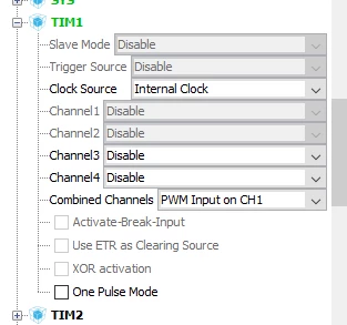

Has anybody converted the PWM frequency and duty cycle measurement exmaple from the STM32CubeMx examples to use STM32CubeMx to configure the hardware (.ioc file to configure the timers)?

The 'STMCubeF2\Projects\STM32F207ZG-Nucleo\Examples\TIM\TIM_PWMInput' example configures the timers with direct calls to the HAL.
I am trying to keep all of the pin allocation and resource initialization within STM32CubMx itself.
Has anyone either created a .ioc file for this or measured frequency and duty cycle using STM32CubeMx to configure the timers?

    Posted on October 11, 2017 at 17:34
    Hello!
    PWM Input mode is selected from the combined channels droplist.
    To start the PWM Input , in your main function, call HAL_TIM_PWM_Start (for both channels).
    Inside TIM1 settings, the counter period(AR Register) must be higher than PWM period you try to measure.
    regards
    vf

    Vangelis Fortounas
    October 14, 2017
    Posted on October 14, 2017 at 00:08
    Hello again.
    It is your choice to use interrupts or not, depending  on what you want to do. It is not mandatory.
    The initialization code produced from CubeMx.
    After Timer initialization in main(.) function, all your code will be
    HAL_TIM_PWM_Start(&htim1, TIM_CHANNEL_1);
    HAL_TIM_PWM_Start(&htim1, TIM_CHANNEL_2);
    Theese functions must de called once to start the PWM input  functionality.
    Parse the captured values values by calling
    HAL_TIM_ReadCapturedValue(&htim1, TIM_CHANNEL_1);
    HAL_TIM_ReadCapturedValue(&htim1, TIM_CHANNEL_2);
    You can call theese functions every time you need to read the captured values.
    The User manual for HAL drivers is inside  HAL firmware  at \STM32Cube\Repository\STM32Cube_FW_F2_V1.6.0\Drivers\STM32F2xx_HAL_Driver.
    Read also about the IT and DMA versions of HAL_TIM_PWM_Start_IT, HAL_TIM_PWM_Start_DMA. It will helps you to decide the best solution for using timers.
    Take a look also inside stm32f2xx_hal_tim.c module. In the begining there is a summary of all tim functions and their use
