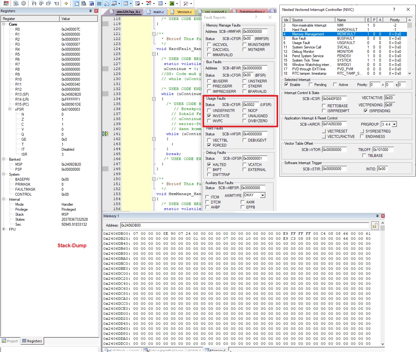

I have a system with several SPIs and logging of data to SD Card. During a test which logged data over night the system ran into a Hard Fault (INVSTATE) after some hours.
My questions:
What is the reason for an INVSTATE Hard Fault?
How can I detect, where the fault occurred?
I dumped the Memory of the Stack (MSP = 0x2406DB20) and the registers - see screen0693W000006GbHoQAK.pngI see adresses like 0x0808C3E9 in the stack, but not at the address where MSP is pointing to.
How do I have to interpret this?

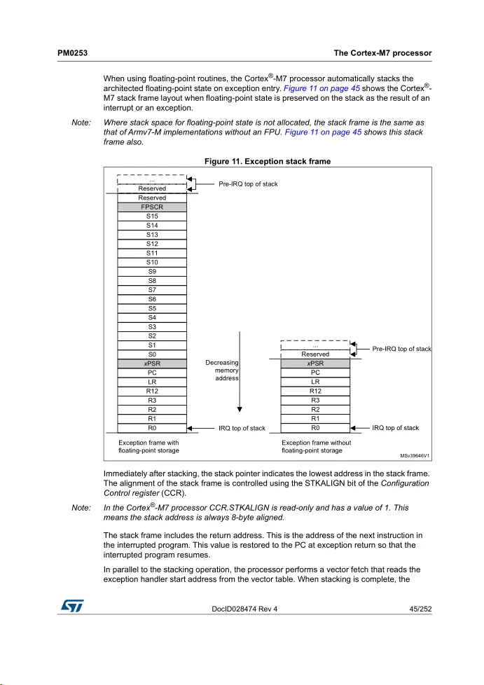

0693W000006GblZQAS.pngStacked PC is zero but that's consequence of the faulty code. LR is 0x0808C3E9, it means that instruction which called the routine which caused the fault, is at address jus before 0x0808C3E8 (bit 0 being set means Thumb mode).

Calling a NULL pointer? Should check callback or stucture elements are non-zero or assert if not within expected ranges.
See previous routines to dump registers​ often quicker than debug view.
