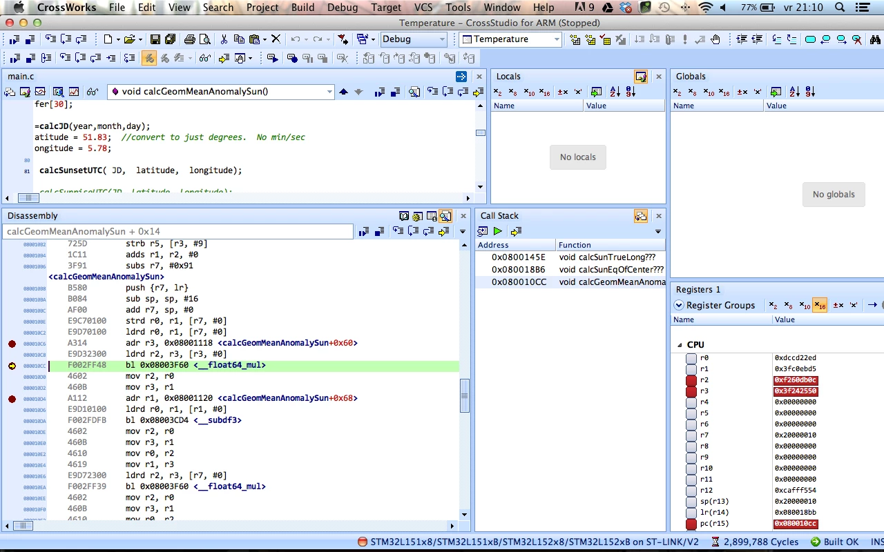

I have a problem which i cannot resolve.
My first code, a DCF77 receiver which update my RTC once a day runs fine without any problems.
Now, i have added a new function to calculate the Sunrise or Sunset time for my location (Lat, Lon)
In that function, another function is called to calculate someting. The first time this function is called, this function will be executed and works fine. the second time, i get a HardFault and i can not find out how.
Sometimes, when it is running in Debugmode and i step slowly thru my code, it executes all my functions without any HardFault.
When i comment the function call my program works fine. Can anybody help me?
I have attached a screenshot of my debugger. As you can see it stuck at __Float64_mul
I guess that it has something to do with the float64. But this function is executed earlier and does not cause a hard fault

    Get a decent Hard Fault handler and know what instruction is actually faulting. Joseph Yiu has published a good one, a while(1) loop is useless unless you want to dig through the stacks and core registers to determine the faulting context.
    Using scanf/printf? do you have an adequate stack allocation?

    i've used a HardFault Handler. But it does not run the whole function. The result of ALL stacked registers is 0xfefefefe ???
    And the strange thing is that when i set the optimization up to 3, the HardFault is gone :(

    The optimization issue suggests again that something there was muddling with the stack, now does so with registers instead. Look at what local/automatic variables you are using, if there is adequate space, or if they can be accessed beyond bounds. Again identifying the faulting instruction and the registers/state at the time narrows the issue.

    Guessing from the access dates of the project files, I would say you use CrossWorks.
    That  leads me to assume that you have a stacksize problem. Crossworks is notorious for having a really small default stack of 128 byte. With your generous usage of double variables, that could easily explain your hardfaults.

    The Crossworks issue about the stack size is also what I have found, These are my stack settings:
    Heap Size: 1024 bytes
    Stack Size (Abort Mode) : 0 bytes
    Stack Size (FIQ Mode): 0 bytes
    Stack Size (IRQ Mode): 0 bytes
    Stack Size (Supervisor Mode): 0 bytes
    Stack Size (Undefined Mode): 0 bytes
    Stack Size (User/System Mode): 1024 bytes
    What do I have to change in these settings. It seems to be enough, right?

    OOPS!!!
    I have found another set of stack options and those settings are the same as you describe.
    And only 3 parameters instead of 7.....
    Now I have changed these into 1024 and 2048 and it runs without any error :)
    Many thanks for helping me...
