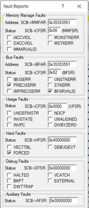

Hi All,
I config UART on interrupt, after receving data on UART simple sending data at that time hard fault occur.

Hal is not proving variable length string on interupt So I make them fix length of string.
Once I get the data after that sending data via
HAL_UART_Transmit(&huart2, response,11,200);
After that... If any once has any suggetion let me know or also tell me how to debug hard fault or any exceptions.

Check what HAL_UART_Receive_IT() actually does. Don't guess.
ASaxe
ASaxeAuthor
November 28, 2019
@turboscrew​ Receive an amount of data in interrupt mode. is there anything specific you want to tell tell me because I didn't get your point
turboscrew
Senior III
November 29, 2019
It doesn't quit do what you expected?

ASaxe
ASaxeAuthor
November 30, 2019
Thanks for you support.
I found the issue.... this because my logic is not working as I expected. or I can say issue in my logic which is leads to a hard fault.
