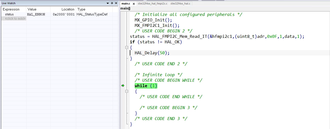

HAL_FMPI2C_Mem_Read_IT() in library "stm32f4xx_hal_fmpi2c.c" claims to be "Read an amount of data in non-blocking mode with Interrupt", yet behaves as a blocking call. Where am I going wrong?
  • February 15, 2023
  • 1121 views
My understanding of a non-blocking function is that the function will return immediately, and it is up to you to use a callback or other method to collect the data. With FreeRTOS it's not difficult.
Yet HAL_FMPI2C_Mem_Read_IT() seems to hang around and reply with a HAL_OK if a device acknowledged the device address or a HAL_ERROR if no Ack is received.
This isn’t the behaviour I expected, and expected a HAL_OK independent of the device responding.

I am aware of the definitions. I have checked the function HAL_I2C_Mem_Read_IT() by setting a pin high before entering, and low after exiting the function.
A, I2C read operation is of 2 parts. The first is a Write, comprising the device address and the subaddress, after that is a repeated read and the device should respond with data.
Until the Ack is received in the first write part of the transaction, the task is blocked.
HAL_I2C_Mem_Read_IT() claims to be non-blocking, but that isn't entirely true; where the write aspect is blocking. It conveniently returns an HAL_Error if a NAK is returned after the write aspect.
Without a status callback indicating an error such as a NAK after the first Write I guess someone has considered this a compromise.
