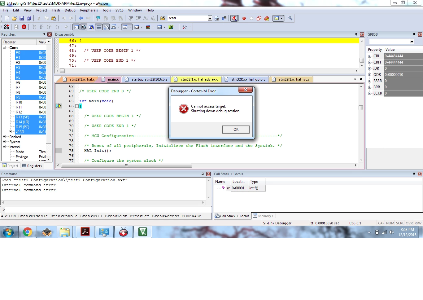

I am new to STM32 controllers. I was doing blinking code. while debugging i got error as cannot access target.Shutting down debug session.
I am using ST-Link2 for debugger and board is from - http://www.dhgate.com/product/stm32-board-core103v-stm32f103vet6-stm32f103/229294742.html#myaccount_orderdetail-1-null
I am using Keil V5.
While debugging i observed in the command window, there was error like - Internal Command error.
I have attached screenshot and code too.

    Such things usually occur if you reprogram the pins used for the JTAG/SWD debug interface, or you enter a low power mode (turn off the pins/core)

    I m using code which is generated by Cubemx. I disabled the function which was disabling the debugging. and the function as __HAL_AFIO_REMAP_SWJ_DISABLE();
