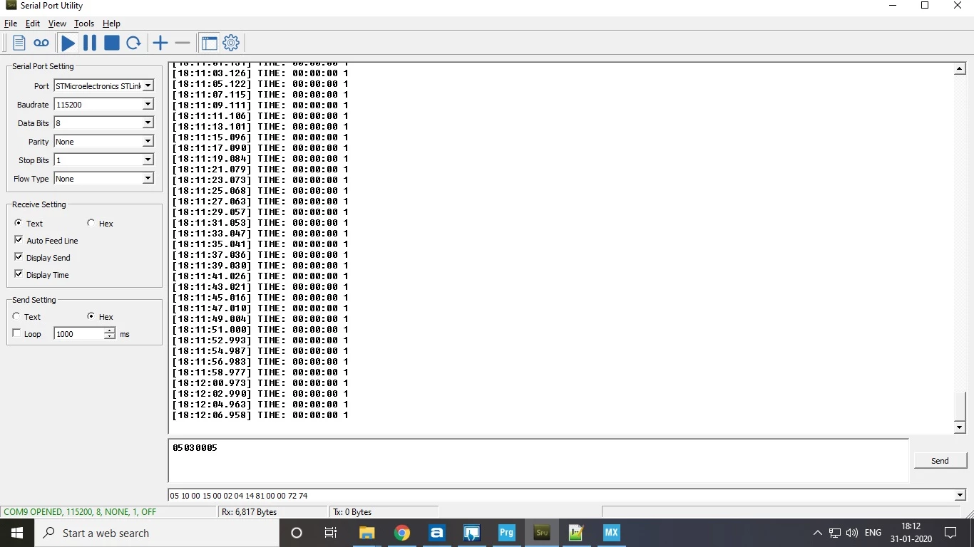

getting internal RTC time always 00:00:00 (I am using STM32F446RE nucleo board )
  • January 31, 2020
  • 1 reply
  • 1570 views
0690X00000BxBKOQA3.jpgI am using STM32F446RE Nucleo Board and want to read internal RTC timing.
But I am unable to get the time getting 00:00:00
Here I shared my core
Clock Setting: LSE : 32768Hz
System Clock: HSI : 84MHz

		 sprintf(buffer,"TIME: %02d:%02d:%02d %d\n",tTime.Hours,tTime.Minutes,tTime.Seconds,HAL_RTC_GetState(&hrtc));
		 send_uart(buffer);
		 bufclear();

bool get_time(RTC_TimeTypeDef gTime)
	if (HAL_RTC_SetTime(&hrtc, &gTime, RTC_FORMAT_BIN) != HAL_OK)
		Error_Handler();
		return false;
	else
		HAL_RTCEx_BKUPWrite(&hrtc, RTC_BKP_DR1, 0x32F2);
		return true;

1 reply
Senior
February 1, 2020
You should use HAL_RTC_GetTime() in your function get_time().
