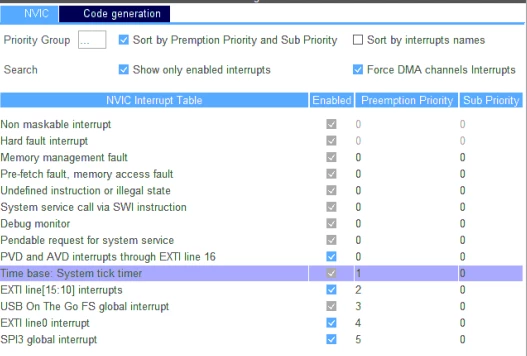

Hello All,
I am working with an STM32H743 and am having issues reliably erasing flash (unreliable in that it fails ~95% of the time). The code which erases flash runs from RAM (functions are allocated in RAM). I disable many of the interrupts before entering the code. I am also invalidating the data cache after erasing the application.
Essentially the code executes without any errors reported. However, afterwards when I connect to STLINK Utility and read the memory contents, some of the sectors are not erased, which were intended to be erased.
Couple of points and observations:
-> Erasing takes maybe 30 to 40 seconds
-> If I do not disable interrupts then while erase code is running I get a hard fault because the Systick interrupt fired.
What is going on here or what am I missing? Appreciate your insights on how to resolve this. A means of debugging the issue would be helpful as well.
Reference manual for this MCU is linked at the bottom of the page.
Below is the starting point for the erasing flash code.
Note I disable the interrupts with priority >= 1.
Interrupt priority listing is available at the bottom of the page.

Here is the listing of the NVIC:

1) One of my possible theories for this issue is that maybe I am disabling an interrupt that is required for the flash erase, do you think this could be possible? I have read the reference manual but I could not find something like this.

Pavel A.
February 24, 2022
(1) No there's no such interrupt. Ensure that systick interrupt does not occur (or relocate the vectors to RAM along with systick handler)
(2) At least with ST-LINK and JLINK, breakpoints in AXI RAM just work. Are you using ITCM or DTCM RAM?
(3) as in your RAM_FLASH_WaitForLastOperation() - the EOP flag.
To exclude effect of caches and the "speculative execution" issue, can you try this again with all caches disabled? (do not call invalidate cache then, because it may fault when cache is disabled).

(1) I had already moved the NVIC to ram (ITCM) via the following code. The systick interrupt still causes an error if I do not disable interrupts.
#define VECTOR_SIZE 166
uint32_t vectorTable[VECTOR_SIZE] __attribute__ ((aligned(512), section(".INST_RAM")));

__set_BASEPRI(0001 << __NVIC_PRIO_BITS);
// Disable DCache
SCB_DisableDCache();
// Erase flash
erase_flash();
// Invalidate data cache
// SCB_InvalidateDCache();
// Enable interrupts
__set_BASEPRI(0);

Well, you've moved the table, but the handlers still are in the flash? or they are in .RamFunc?
To keep it simple, disable all interrupts with __disable_irq().
By the way alignment of vector table must be 1024, I've just learned this in a hard way.
The cache is disabled after reset, simply do not enable it.
When it starts working, add some timeout detection instead of unlimited loops in lines 95, 118,
Check that there's no write protected sectors.

1) Well, you've moved the table, but the handlers still are in the flash? or they are in .RamFunc?
More likely than not they are in flash. How can I move them to Ram? Would adding the .RamFunc directive be sufficient?
2) By the way alignment of vector table must be 1024.
Do you have a source for this? I've been using 512 for the last little while.

 4) Check that there's no write protected sectors.
Confirmed no RDP or WRP. I do want to add those in soon. Apart from disabling WRP are there any other considerations?
