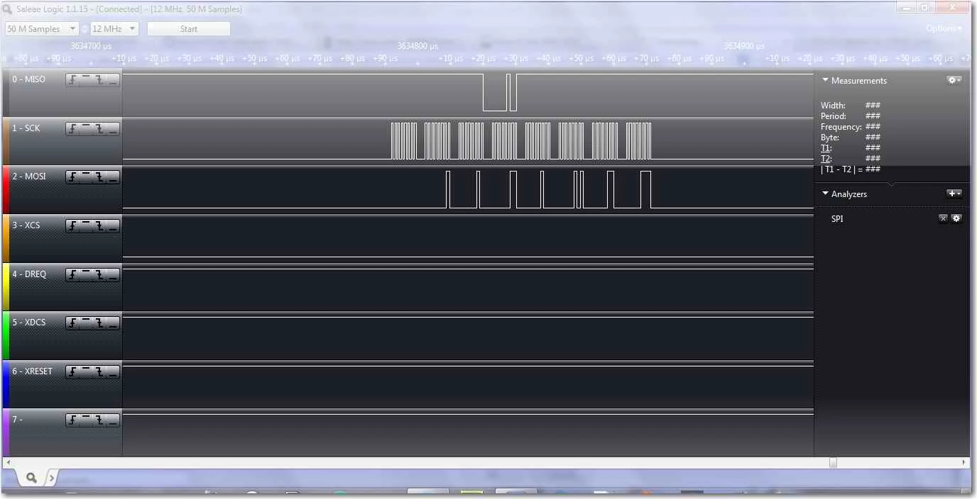

    antonius
    antoniusAuthor
    January 24, 2016
    Posted on January 24, 2016 at 21:05
    I'm sure as well that ST is not the author of Chan FATFs too,that's what I've been thinking, on the low level, since from Chan FATFs, it's using const *byte....
    but in here I can't compile it, it's not compatible with HAL_SPI_Transmit which is uint8.... I'll see with logic analyzer, what it's doing from the beginning of SPI2...
    Yes I'm basically copying between STM32 and AVR, but not completely, because if it's completely copying, I will not get the trouble finding out why is not compatible, right ? :)
    Anyway, I've checked with my logic analyzer previously to send a simple 0x00, 0x01 at SPI2, and it works, but I haven't seen it sending the function I've ported on diskio.c....
    There's another question between diskio.c and user_diskio.c.....Can I ignore user_diskio.c...or anyone from ST can tell me what is this file for to make me understand easier ?
    So far I ported all my codes from my AVR inside diskio.c, when I call f_mount, I can see from UART, it's doing the job....
    Thanks

    antonius
    antoniusAuthor
    January 25, 2016
    Posted on January 25, 2016 at 13:04
    I've tested xmit_spi_multi and it did the job properly,
    void test_function()
    //test function from diskio.c here
    uint8_t data_test[8] = { 0x00,0x01,0x02,0x03,0x04,0x05,0x06,0x07 };
    xmit_spi_multi (data_test,8);
    //test only
    void xmit_spi_multi (
    BYTE *p, /* Data block to be sent */
    UINT cnt
    while(HAL_SPI_GetState(&hspi2) != HAL_SPI_STATE_READY);
    HAL_SPI_Transmit(&hspi2,p,cnt,100);
