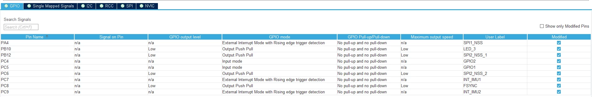

Hi. I have two sensors connected to an STM32f410r8t6, where they send a high signal whenever new data is ready to be read.
Pin connections are as follows:
PC9 (GPIO_EXTI9) -> INT_IMU2
PC7 (GPIO_EXTI7) -> INT_IMU1
I have them setup as follows in the ioc file.
0693W000006ERm9QAG.png0693W000006EReBQAW.pngThe GPIO and NVIC code is automatically generated.

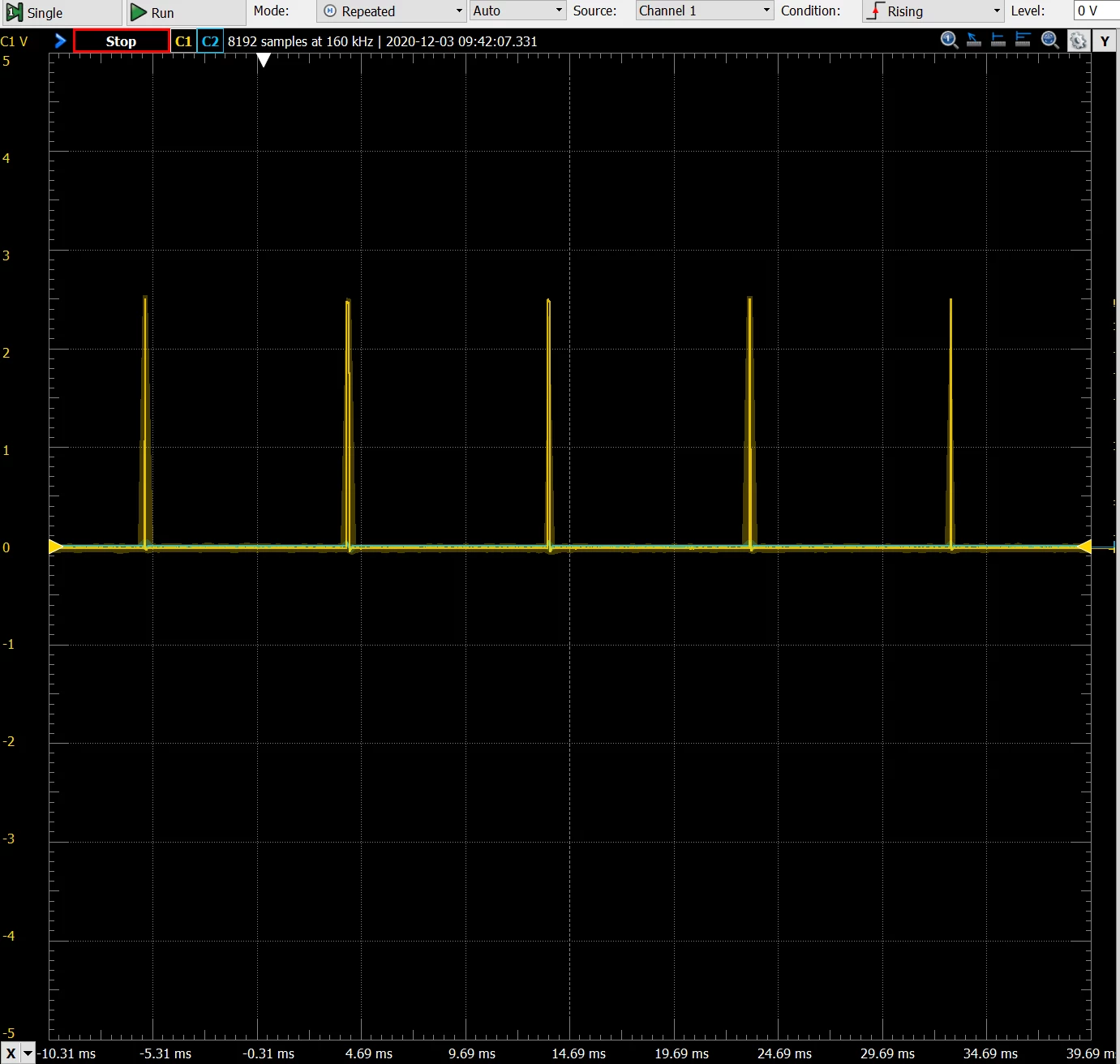

When I debug the program, it never enters the interrupt routine. The flag isn't set, and the LED doesn't toggle.
Looking at the line with an oscilloscope I see that the pulses are there:
0693W000006ERsMQAW.pngThe high signal is 2.5 V, which should be high enough, as the datasheet for the MCU specifies 0.7*VCC is accepted as V_Hin, and the MCU is supplied with 3.3 V
What stupid thing am I missing?

Debug as usually, i.e. read out and check/post the relevant GPIO, EXTI, NVIC registers content. Observe EXTI registers if the pulse is captured. Make sure the ISR is properly inserted in the vector table, best in disasm.

Thanks for your reply. I found the error half an hour ago, turns out I had written my callback function in all caps. CALLBACK instead of Callback resulted in the function never executing.
