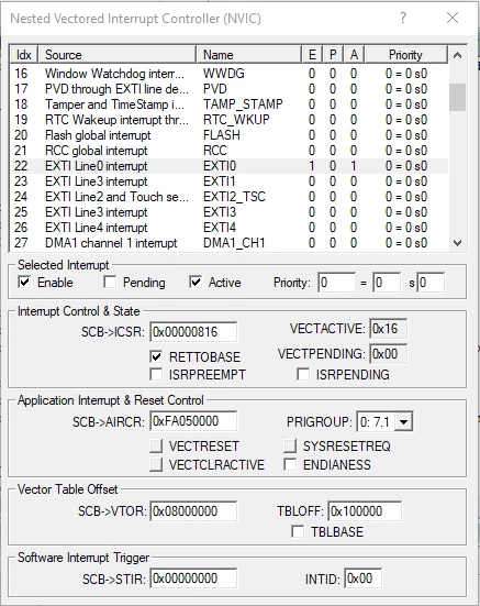

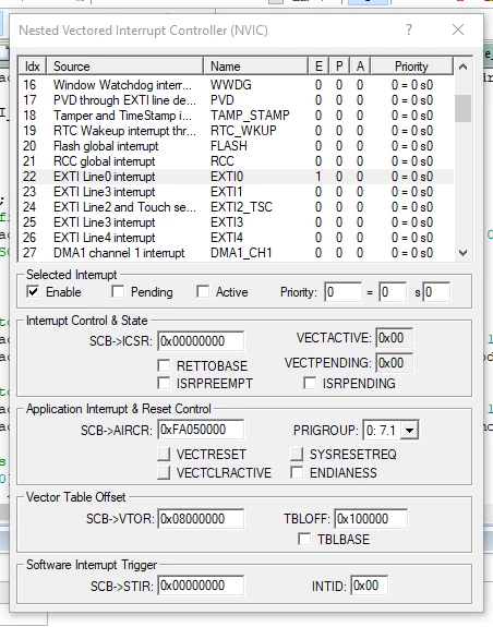

Hi, I'm trying to execute an interrupt with the pin PCO with stm32f303re Nucleo board, but the interrupt routine never executes, actually, it just stops the program. this is my configuration code for the interrupt:
//set gpioc 0 as interrupt
 __disable_irq();
 	SYSCFG->EXTICR[0] |= 0x2;
	EXTI->IMR |= (1 << 0);
	EXTI->RTSR &= ~(1 << 0); //configure pin 0 as interrupt, fall edge
	EXTI->FTSR |= (1 << 0);
	NVIC_EnableIRQ(EXTI0_IRQn);
	NVIC_SetPriority(EXTI0_IRQn, 0);
	__enable_irq();
and this is my Interrupt routine:
void EXTI0_IRQHandler(void) {
	counter2++;
	EXTI->PR |= EXTI_PR_PR0;
and in the debug view i can see that the processor triggers the interrupt, but it just stuck the program and the interrupt is never executed:
before pressing the button connected to PC0:
0693W00000ANkrMQAT.pngafter pressing the button:
Thanks for any help.

waclawek.jan
May 8, 2021
If you stop execution in debugger, what do you see, where is the PC, how does the ISR look like?
JMart.13
JMart.13Author
May 8, 2021
when you refer to PC as the port? and which one is ISR? I know that peripherals like i2c and usart have ISR, but EXTI does not have one.
waclawek.jan
May 8, 2021
No, Program Counter, i.e. which is the currently executed instruction, is it in the ISR?
ISR is the Interrupt Service Routine Ii.e. here EXTI0_IRQHandler()); I am interested in how it looks in the disassembly view.
JMart.13
JMart.13Author
May 8, 2021
Honestly, this is what i have seen, the compiler does not create asm code for the ISR, i don't know why, so i can't see it in disassembly view. I don't know if this helps
waclawek.jan
May 8, 2021
That's problem.
What toolchain are you using?
Consult the toolchain's manual for proper way to use ISRs, study available examples. Some toolchains require a special way to tag ISRs, to prevent them being optimized out.
Check if the ISR's name matches that in the vector table (case sensiive), which is usualy located in the startup file.

JMart.13
JMart.13Author
May 9, 2021
Ok, I was experimenting because I literally copied and paste the code, but it seems the problem is that the version i was running in keil uvision is C++ and in the CUBE IDE was C, so I changed the C++ type file in keil to C and it works perfectly. Any idea why?
Tesla DeLorean
Guru
May 9, 2021
C++ uses name mangling
use form
extern "C" void EXTI0_IRQHandler(void) {
