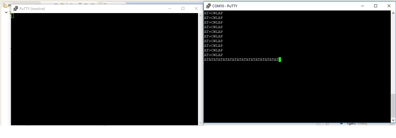

I am interfacing ESP8266 with my Murata LoRa board(though not using LoRa), so let us just say I am using STM32L072CZ with ESP8266 connected on UART1(Pin9,10). I am seeing a strange behavior from STM UART.
The code being used is as below,
//HEADERS
char cmd[]='AT+CWLAP\r\n';
int main()
//INIT
while(1)
HAL_UART_Transmit(&huart1,(uint8_t*)cmd,strlen(cmd),0xFFFF);
This works well for the first few iterations and then fails as seen in attachment. Please help and pin point the problem and solution.

What is the return value from HAL_UART_Transmit()?
Try setting a breakpoint when the error occurs to inspect registers, etc.
Note that you don't need the \n here.
It should be benign, but better to get rid of it and remove all doubt ...

Please make use of the Syntax Highlighter to properly present source code:
while(1)
 HAL_UART_Transmit( &huart1, (uint8_t*)cmd, strlen(cmd), 0xFFFF );
That is a great way to crash any AT Command interface!
You should never send another AT command before you have had the full response from the previous one!

I made the foolish mistake of using the Syntax Highlighter - so that post is now stuck in Moderation.
Sending out commands in a tight 'while' loop is a sure way to crash
any
 You should
never
full
