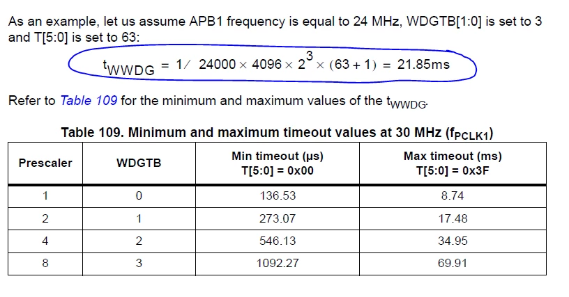

Hello @Hoang_Tran​ ,
You are right, I confirm the error in this equation and raised this internally for correction.
Thank you for highlighting this.
