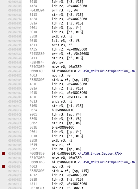

    The source-code around the fault (from stm32f7xx_hal_flash_ex.c) is as below. I have added the suffix _RAM to routines that are placed in ITCM RAM:

    Single-stepping disassembly is (too small for me to see):
    Or as a code-snippet without the addresses
     9B01 ldr r3, [sp, #4]
     689B ldr r3, [r3, #8]
     9302 str r3, [sp, #8]
     E01E b 0x0000010C
     691B ldr r3, [r3, #16]
     B2DB uxtb r3, r3
     4619 mov r1, r3
     9802 ldr r0, [sp, #8]
     F000F830 bl 0x0000013C <FLASH_Erase_Sector_RAM>
     F24C3050 movw r0, #0xC350
     F000F886 bl 0x000001F0 <FLASH_WaitForLastOperation_RAM>
     4603 mov r3, r0
     F88D300F strb.w r3, [sp, #15]
     4B12 ldr r3, =0x40023C00
     4A11 ldr r2, =0x40023C00
     F02303FA bic r3, r3, #0xFA
     6113 str r3, [r2, #16]
     F89D300F ldrb.w r3, [sp, #15]
    If I execute by single-step the "9802 ldr r0, [sp, #8]" then I get the fault. So by implication we're getting enough speculative-execution of enough of "bl <FLASH_Erase_Sector_RAM>" to start the write. I've specified FLASH_VOLTAGE_RANGE_3 so there's quite a lot of code to execute in:

    So I'm not convinced of that amount of prefetch/speculative execution.
