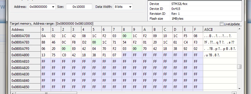

I'm trying to program my application to user flash memory (0x08000000) via the DFU mode with the embedded bootloader. However, the application is always programmed incompletely. See the attached picture.
There is still some data after 0x0800A807 like below ( captured from the .hex file ).
:10A804001838F1071CF7068000F8C61850F1001C30
:10A81400F2020888611CF201021C62011CFD02D1D3
:10A824000431548204A8613C92071CF20A801C2162
:10A8340015921250A2041CF20A021CF20A201CF205
:10A8440006401C4E0848038312008C79B04E084819
:10A8540003F1071C83000854294C920654F30600A4
:10A86400101CFA0100A0A20A1CF20A101CFA0640ED
:10A874004C460018E102711CF20A0454F206201C32
:10A88400FA0508BC611CFD082C03FE0A08EC04460A
:10A8940008DCE1027550F107C4861034D30100A826
I am using STM32L486. Has anybody already got this problem? or has some idea about this?
Thanks in advance.

    Posted on September 07, 2016 at 04:43
    Thanks, clive.
    I did re-generate the HEX from the DFU. The new HEX looks same as the original one.
    I found this problem when I am trying to upgrade my own boot program via the embedded bootloader. I also found another strange thing is sometimes the embedded bootloader can't upgrade my application program starting from 0x08010000. The reason looks same that verification failed. But my own bootloader can do this!

    Posted on September 07, 2016 at 08:46
    Found the root cause in section 46 of AN2606:
    For memory write operations using DFU interface:
    If the buffer size is larger than 256 bytes and not
    multiple of 8 bytes, the write memory operation
    result is corrupted.
    Workaround: if the file size is larger than 256
    bytes, add byte padding to align it on 8-bytes
    multiple size.
    Write in SRAM is corrupted.
    After manually aligning the HEX on 8-bytes before generating the DFU, then DFU upgrade succeeds.
