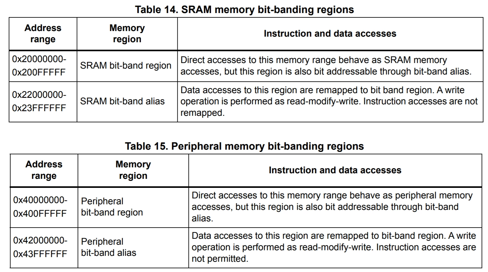

Bit banding addresses are shown in the programming manual. Not everything is bit banded.
Source:
https://www.st.com/resource/en/programming_manual/dm00046982-stm32-cortexm4-mcus-and-mpus-programming-manual-stmicroelectronics.pdf

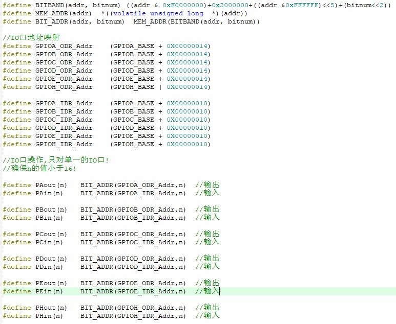

as Uwe mentions below, you don't need bit banding for the GPIO registers - use the BSRR register. From the reference manual "The purpose of the GPIOx_BSRR and GPIOx_BRR registers is to allow atomic read/modify accesses to any of the GPIOx_ODR registers."

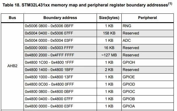

So, are the GPIO addresses within the area which is bit-banded (see TDK's post above)?
HSX.1
HSX.1Author
December 8, 2020
December 8, 2020
Are those addresses within the bit banded region of the above table?
