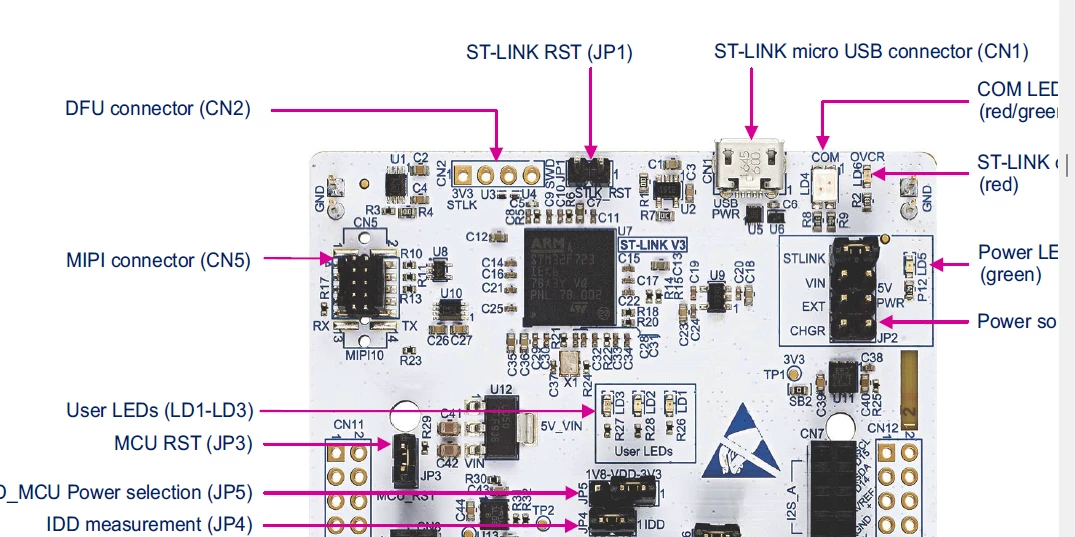

I am trying to debug my Nucleo H723ZG board using the CN5 (MIPI10) and a Segger J-Link Pro. But I have tried both methods described in the UM2407 6.3.3 "Using an external debug tool to program and debug the on-boards
STM32H7" and neither allows the J-Link to connect to H7. When I attempt to start a debugging session, I get the following error message:
And the J-Link startup dialog looks like this:

the CN5 connects to the onboard st-linkV3 . did you disable this ?
so dont connect j-link , use the onboard st-linkV3 , connect PC to CN1 USB (micro usb probably).
is it (still) working?

AScha,
"so dont connect j-link , use the onboard st-linkV3 ,"
I need to use the J-link for more complex dual-board debugging. I don't want to use the on-board ST-Link.
"the CN5 connects to the onboard st-linkV3"
..not according to the documentation. CN5 is the MIPI debugging connector as shown below.
"did you disable this ? "
I did jumper the STLINK-RST pin, but this appears to also disable the power supplied to the CPU. My J-Link cannot connect to the CPU.
Again, I prefer to use the more powerful J-Link Pro for debugging. How can I do this with the Nucleo board?

ok, so you want/need j-link...hmm.
look at circuit:
https://www.st.com/en/evaluation-tools/nucleo-h723zg.html#cad-resources
jumper the STLINK-RST pin, ok. but seems, hse + lse not fitted on board, so you cannot run with external clocks, except you have mount them on board + connect (solder bridges); (and st-link under reset -> no clock to H7 cpu !)
then decide, how to power it...and st-link needs to be powered also, even in reset, because connects also to cn5.
you should get connect with j-link, "under reset", because cpu starting then on internal HSI clock.
so: some work, to run it with j-link. :)

Tesla, "Probably move jumper from JP3 to JP1. And JP2 to CHGR if using USB-C to power"
This does let the J-Link to connect to the MCU, but as mentioned by Ascha, the chip is now not receiving a clock from the debugger. Seems a bit confusion that the documentation clearly implies that this can be done.
6.3.3 Using an external debug tool to program and debug the on-boards
STM32H7
There are two basic ways to support an external debug tool:
1.Keep the embedded STLINK-V3E running.
Power on the STLINK-V3E at first until the COM LED lights RED. Then connect your external debug tool through the MIPI-10 debug connector (CN5).
2. Set the embedded STLINK-V3E in the high-impedance state:
When the STLK_RST jumper (JP1) is ON, the embedded STLINK-V3E is in the RESET state, and all GPIOs are in high impedance. Then it is possible to connect the external debug tool to the debug connector (CN5).
