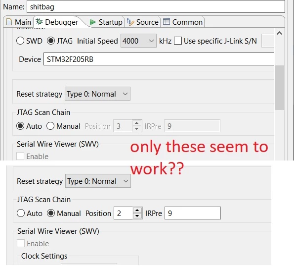

Hello, I have a 4 identical microcontrollers daisy chain wich seems to work...exept I detect 8 devices?... My setup is the folowing...I have a segger J-link edu mini and 4 wire JTAG. basically I dont got JTRST but NRST connected to the J-link... In tis event should my reset strategy be Type 0:Normal or None?? Boot 0 is shorted to GND.
Something seems to work, as I can enter the debugging session and get this log below. But my true goal is to precisely select ny microcontroller on this chain and debug this and get to work. I seem to be only able to program tap #auto(position 0?) and position 2... Why IRPre9?? No idea...Saw this in a post.
J-Link found 8 JTAG devices, Total IRLen = 36
JTAG ID: 0x4BA00477 (Cortex-M3)
Connected to target
Waiting for GDB connection...Connected to 127.0.0.1
Reading all registers
Read 4 bytes @ address 0x080004D8 (Data = 0xB580E7FE)
Read 2 bytes @ address 0x080004D8 (Data = 0xE7FE)
Anyways, this is not my main problem, I am just confused as to why I get this effect, no numerical combination of position and IRPre seem to work.

Uwe Bonnes
Chief
December 8, 2020
A CortexM Device Jtag chain is already two devices. One for debug access and one for Boundary Scan/IO-access.JTAG ID:0x4BA00477 and similar is Cortex-M3debug. 0x064xx041 are the boundary scan devices.

Uwe Bonnes
Chief
December 8, 2020
List the chain and tell your debugger to connect to the right device.

Uwe Bonnes
Chief
December 8, 2020
Learn about Jtag chains. Some tools offer you more insight about the chain. I do not know about the segger tools. There are probably 5 bit used for the Debug TAP and 4 bits for the Boundary Scan TAP. So you have 9 bits before then second chip.
