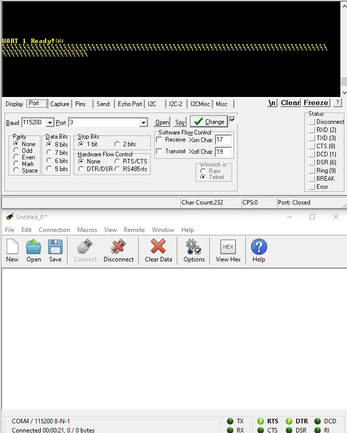

What I am trying to do:
Send and receive data via USART on my STM32H7B3I-DK. I am connecting a serial USB to the STMod+ CN10 RX and TX and have 2 serial consoles on for monitoring the data that is transmitted on both ends (the serial USB and the discovery board).
What I have done:
I have generated a code with both USART1 and USART2 enabled. (USART1 for outputting the data that goes to the discovery board and USART2 to enable data transfer to the serial USB.) I then added a few lines of code (shown below) in the main loop to send and receive data.
I have also tried switching to USART3 on (CN11) but there is still no data being sent or received. I have also tried connecting to the ESP-01connector (CN4 of STMod+) , which should also be routed to USART2, but the result is the same.
Could someone provide me with some insight? Thank you for your help!
Debug one thing at a time. Where is USART1 hooked up specifically? The user manual says it is used for the VCP, is this what you're monitoring?
How do you know it's not working? Are you looking a signals on the wires or are you just monitoring console output on your PC? Or something else?
JTurn.2
JTurn.2Author
October 18, 2021
Hi, thank you for your reply. UASRT1 is hooked to the VCP which is outputted via CN14 (the USB STlink). It's not working cause there is nothing being outputted.
I just used a multi meter to test for a signal. I hooked up an esp8266 which outputs in serial and found that there is a voltage drop when there is data being transmitted. I then checked the data line (STM32 Tx on the STMod+ to Rx of the serial USB). There was no voltage drop. So I'm assuming there's no data being sent. I have also attached two pictures showing the output from the serial consoles. The top console is the STM32's serial while the bottom one is the output for the serial USB.
Note: I added a test string to UART1 to test that it's working properly

Please ignore that the port for the top serial console is closed. I turned it off before I screenshot the images
