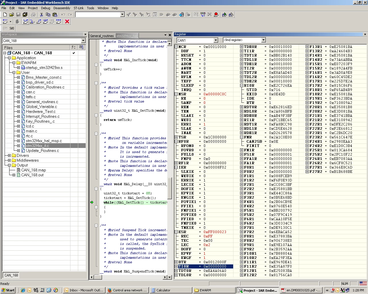

Am facing issue in recieving interrupt in COntrol area netwaork of Stm32f427zgt6 controller,
I have set Can as Master mode .
Also when a single slave is connected with ID - 0 , Can peripheral do not sense interrupt, but moment a new ID is added in paraller as a slave with ID - 1, both statrt to get sense.
Can any one explain this behavior , also y am not recieving interrupt when single slave is connected with ID-0
Rohit
Thanks in advance.

rohit2
rohit2Author
May 13, 2017
Posted on May 13, 2017 at 10:04
Dear clive i wanted to share register values am obtaining while debugging , please have a look.
Above image is the image taken when no slave device is connected.

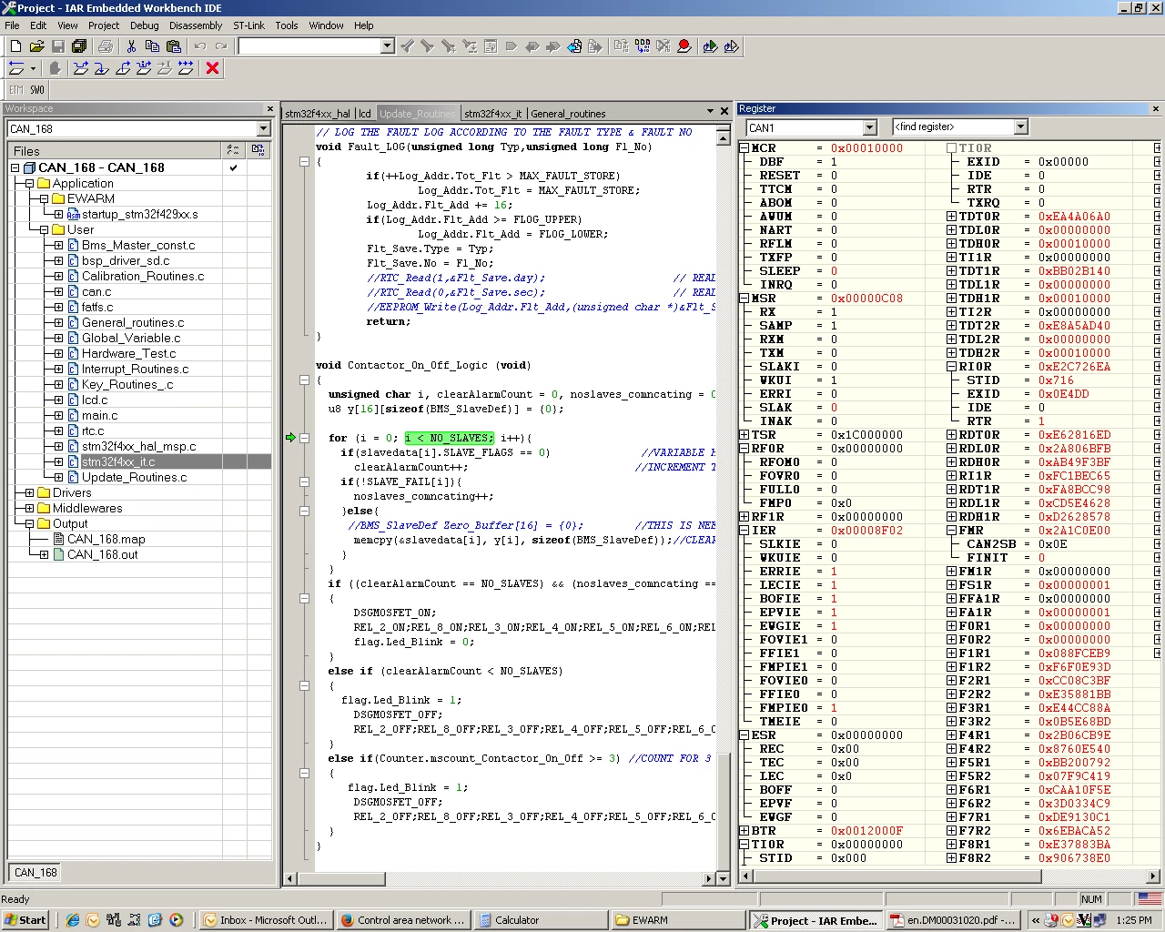

Above image taken when slave with ID-1 connected to my hardware, please have a look at ESR register, which is CAN error status register. Which shows lot of errors registered upon recieve of data, but still i didnt recieve any interrupt..
Tesla DeLorean
Guru
May 13, 2017
Posted on May 13, 2017 at 15:01
You'd have to dig into the HAL to understand why the interrupts are not dispatched to you.
Yes the error count looks very high, perhaps you should be looking at the transceivers and termination on the bus, especially if add additional devices to the bus changes its behaviour.
