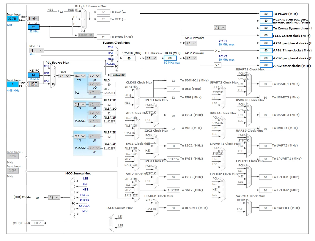

I use the STM32CubeMX to send data using UART, but I have a clock frequency problem,
I configured the clk as shown on the picture below

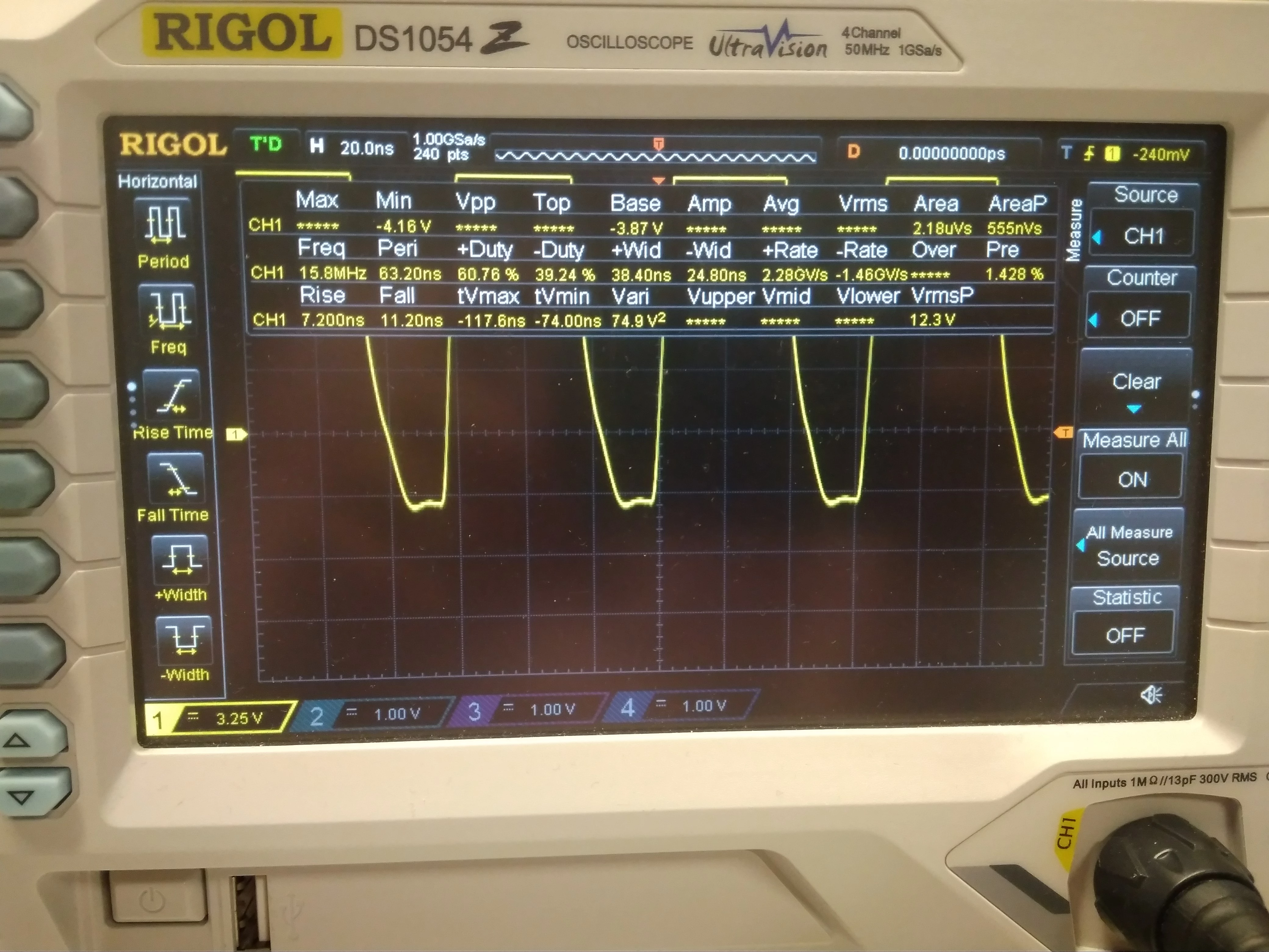

logically, I should obtain 80MHZ as an outpout frequency, but when I use the scope, it is
fixed
all of the time at 16 MHZ if I use MSI or HSE as shown on the picture below

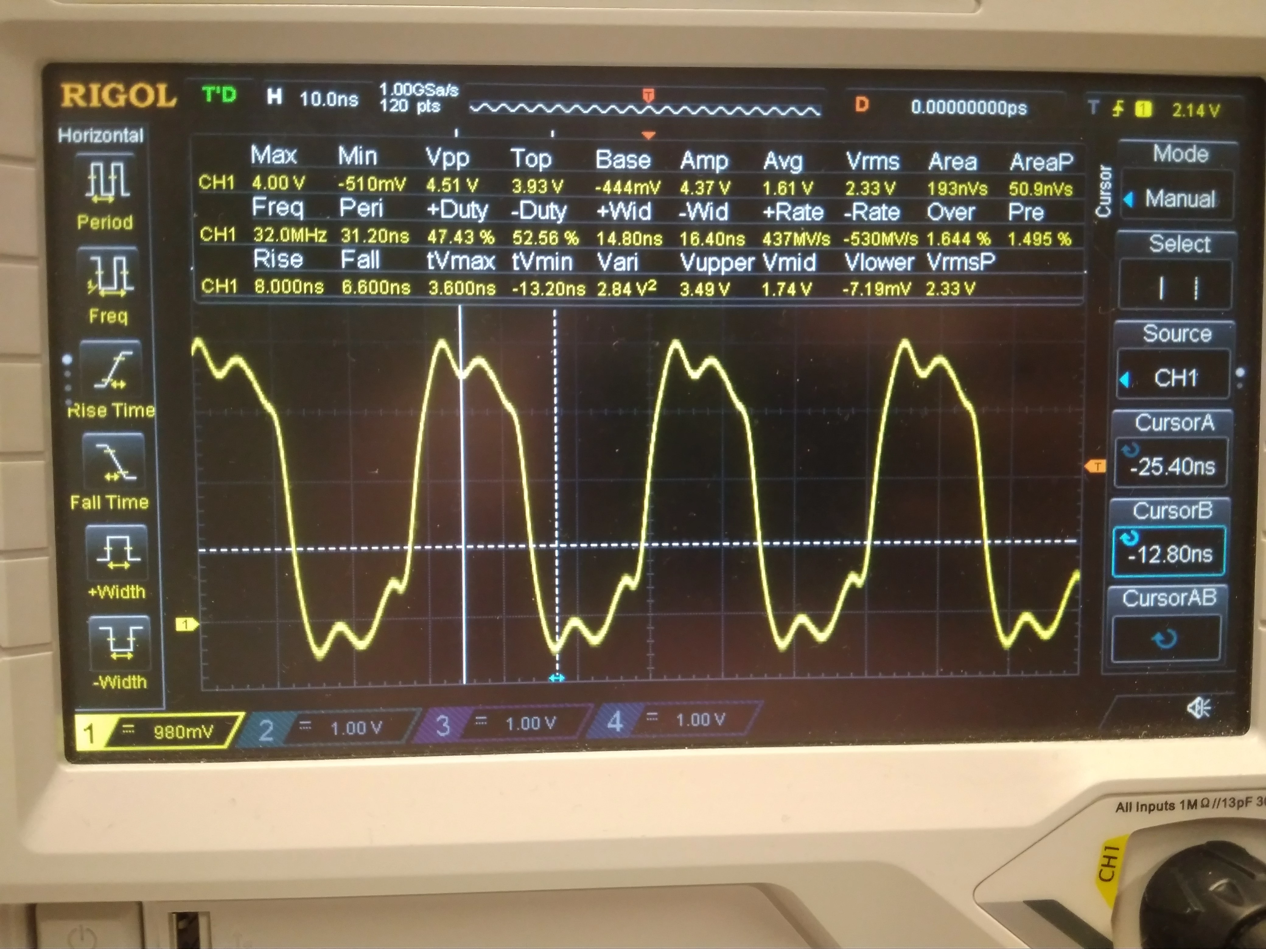

and it is fixed at 32 MHZ if I use the HSI,
I tried to use the different divisions /1, /8.. and the different clk (PPLCK, SYCLK, HSE...) to obtain the correct frequency, but everytime, I have the same frequency output that I showed on the scope,

    Hello Mohamed,
    Looking at your clock tree I assume that you work with STM32L4 MCUs family.
    It could be that you faced CubeMX issue with code generation for clock domain. Could you please take a look on this thread:
    https://community.st.com/0D70X000006SldESAS
    ? The issue described there is wrong PLLM parameter set by CubeMX.
    Regards

    Hi Mohamed,
    This is due to the lack of the PLLM configuration, it is a known issue and will be fixed next release.
    As workaround you can use the LL driver for RCC code generation.
