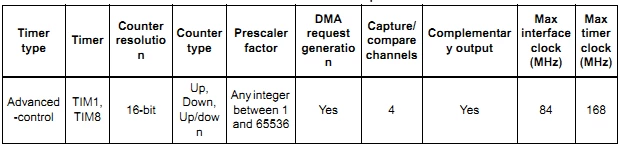

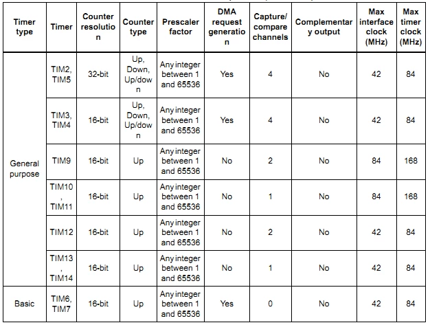

hi everybody
i want to have 8 channel pwm input and 8 channel pwm output in stm32f407vgt6
here is the table of timers in this micro . i also want to have a time scheduling .from your perspective which combination of these times is suitable for 8channel input and which one for 8 channel pwm output and  which one is  good for time scheduling ?

    Doing the due diligence here would seem to take more time than I'm willing to expend, so I'll make some suggestions that might save you some time.
    The manual for the board describes the available pins, this is going to limit your options. To do PWM Input mode you are going to need to find EIGHT timers, providing CH1 or CH2 pins. This is likely to be an impossibly high hurdle. Your post provides insufficient detail about the nature/speed of your signalling, so I'll assume it's something slow and mundane like a 50 Hz Servo, and the signals are all very similar in specification so can share a timer. I would suggest using the 32-bit timers to time stamp signal edges using Input Capture mode, where possible.  And use which ever 16-bit timer pins you have available to generate the PWM Output.
    Use SysTick for continuous time base requirements, set it to 1 KHz, or whatever the granularity of the requirement is, have it dispatch tasks, decimate, or count off other time related events/signals.

    thanks clive.
    that's right i want to handle 8 50hz servos separately . but why i should use 8 timers for 8 channel input pwm. i mean for example timer2 has 4 channel i can not use each channel for each input ??
    Not it PWM Input mode you can't, it uses a pair of channels, and resets the timer. Review manual and examples thereof, and then explain to me how this is going to work. For a one-to-one channel to signal ratio you'd have to be using Input Capture mode.
    Are all the servo input guaranteed to be synchronous with each other? Perhaps you can use CH3 and CH4 to latch secondary channels?

    As I said the channels are paired, they deliver period/duty, and reset the counter to do so.
    I've also said several times you need to use Input Capture mode to time stamp the edges if you want to use multiple channels of a timer. You then need to manage the measurements via interrupts.

    Posted on August 25, 2014 at 18:37
    TIM_ICPolarity_BothEdge
    Time stamp BOTH edges, shouldn't be hard to figure which set of measurements represent 50 Hz (20 ms) period, and what the duty is.
