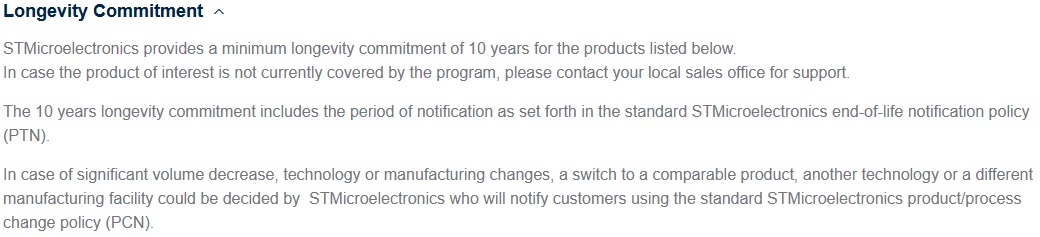

Hi, I have no specific information to share on my side, but you could find that STM32H757 is part of 10 years longevity program, so guaranteed production for 10 years (currently renewed every years) : https://www.st.com/content/st_com/en/about/quality-and-reliability/product-longevity.html#10-year-longevity&section=FM141-10-year
_legacyfs_online_stmicro_images_0693W00000bhfusQAA.pngThis does not guarantee any lead time or parts allocation concerns which depend on manufacturing capacity and product popularity.
