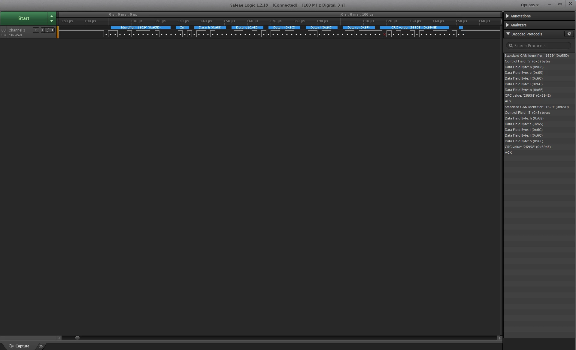

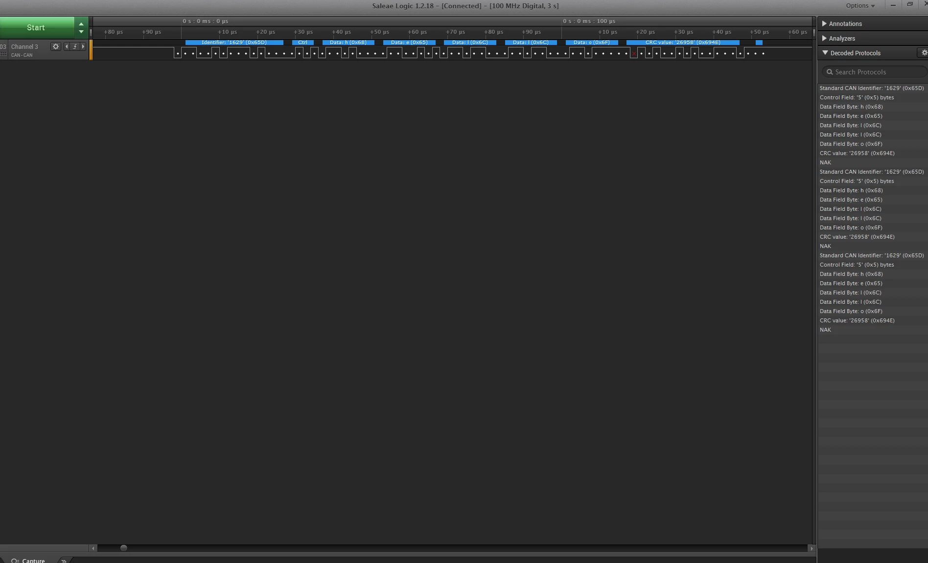

here you can see successful messages sent on the can bus but only 2/3 before the error in the HAL_CAN_AddTxMessage() code ??
here we can see two / three messages getting sent before the error at the HAL_CAN_AddTxMessage code
 This is on the CAN RX pin of the Nucleo Board
This is on the CAN TX Pin Of The Nucleo Board

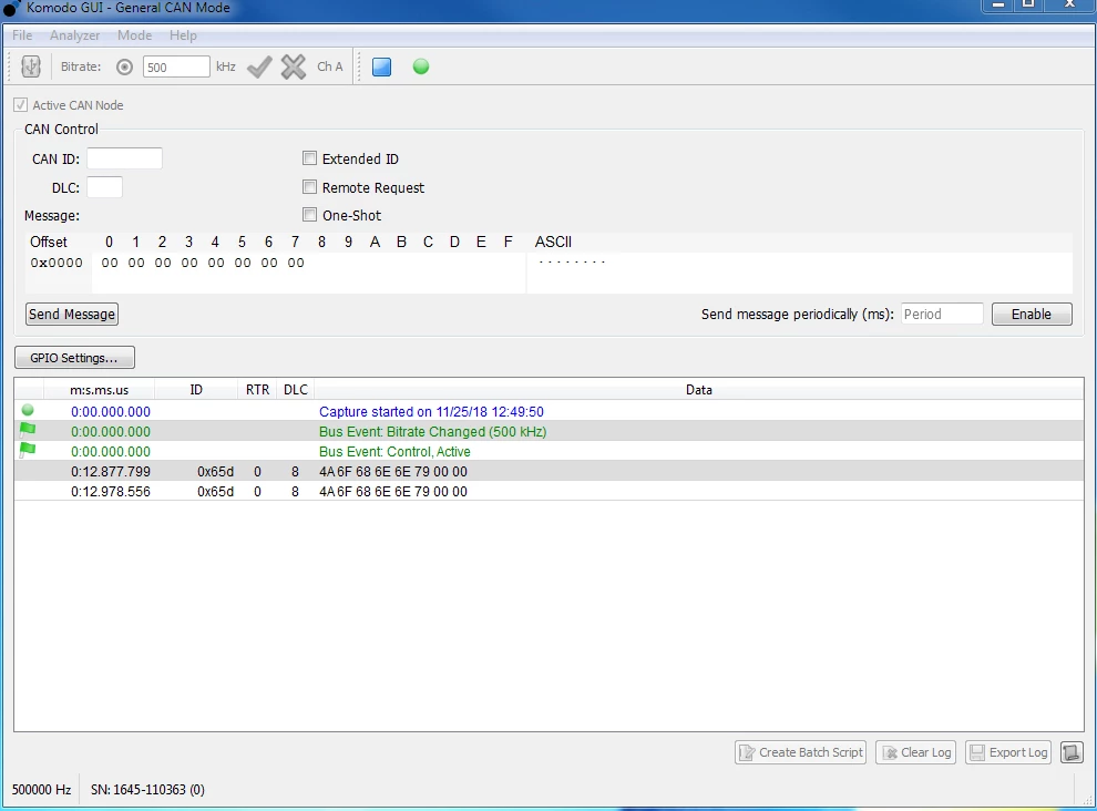

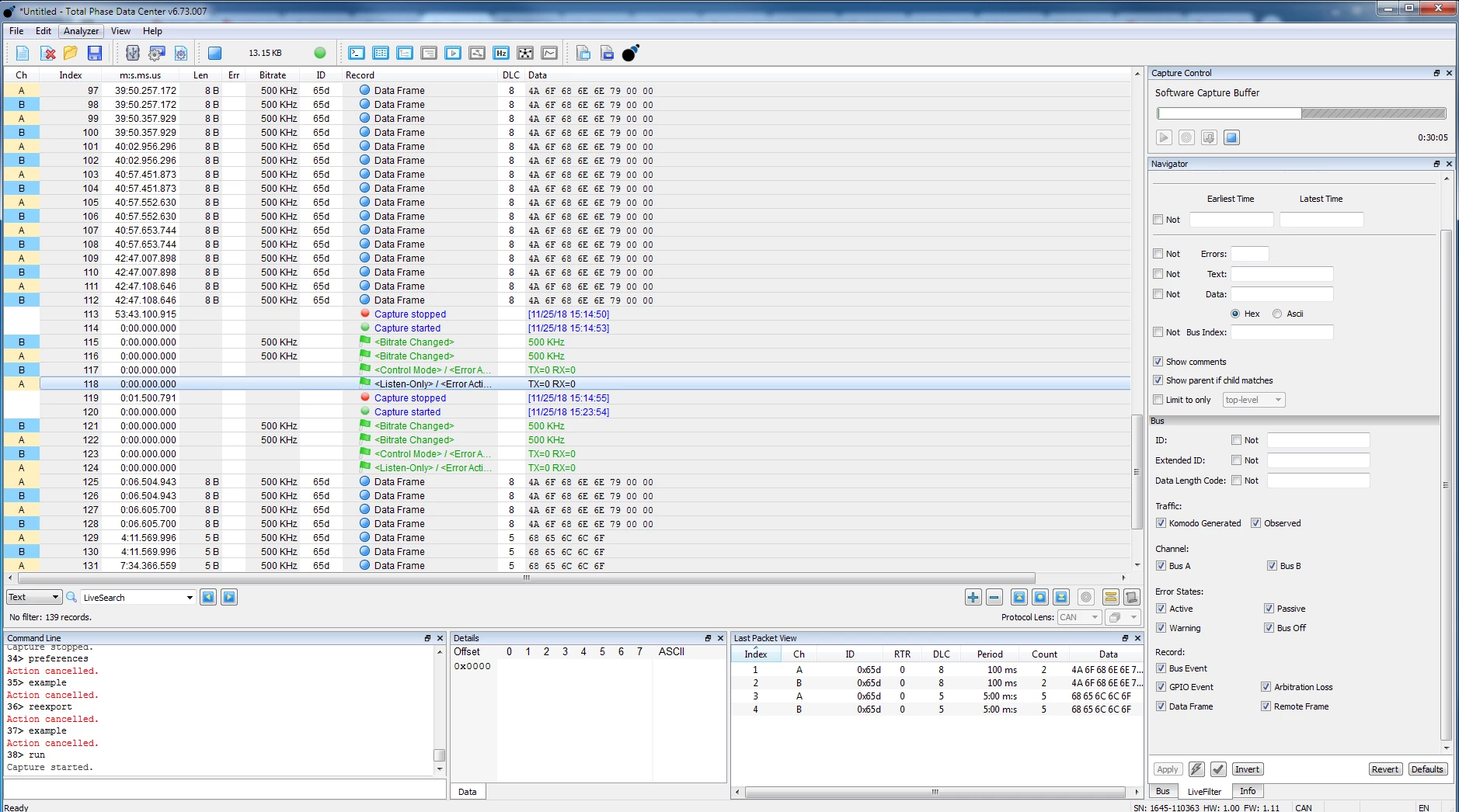

Both in my logic anylyser and CAN Bus Analyser I can see the successful transmission of the two messages

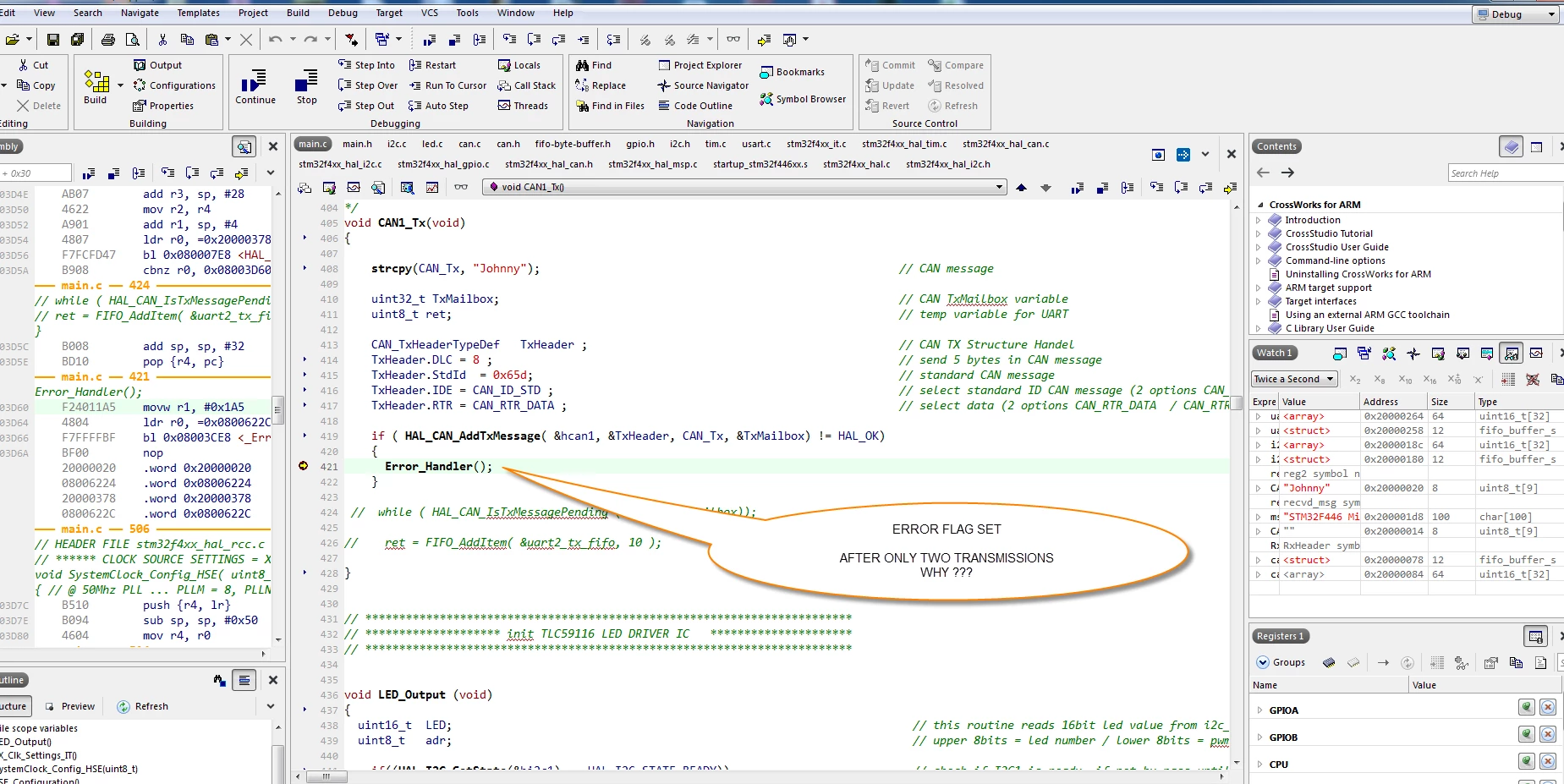

WHY WHY WHY is the ARM triggering an error ???? after only sending 2 messages
It should send the messages for the next year! or until I hit the stop button in my debugger
any help will be appreciated
Thanks in advance, oh this is now getting to me, it should be fun, but its now becoming a pain for the amount of time I am wasting
Oh I also get a CAN ERR interrupt generation and error code of 0x1000
CAN ERROR 0x1000 is
(0x00010000U) /*!< TxMailbox 1 transmit failure due to tranmit error
why does this only transmit 2 messages and then error ???

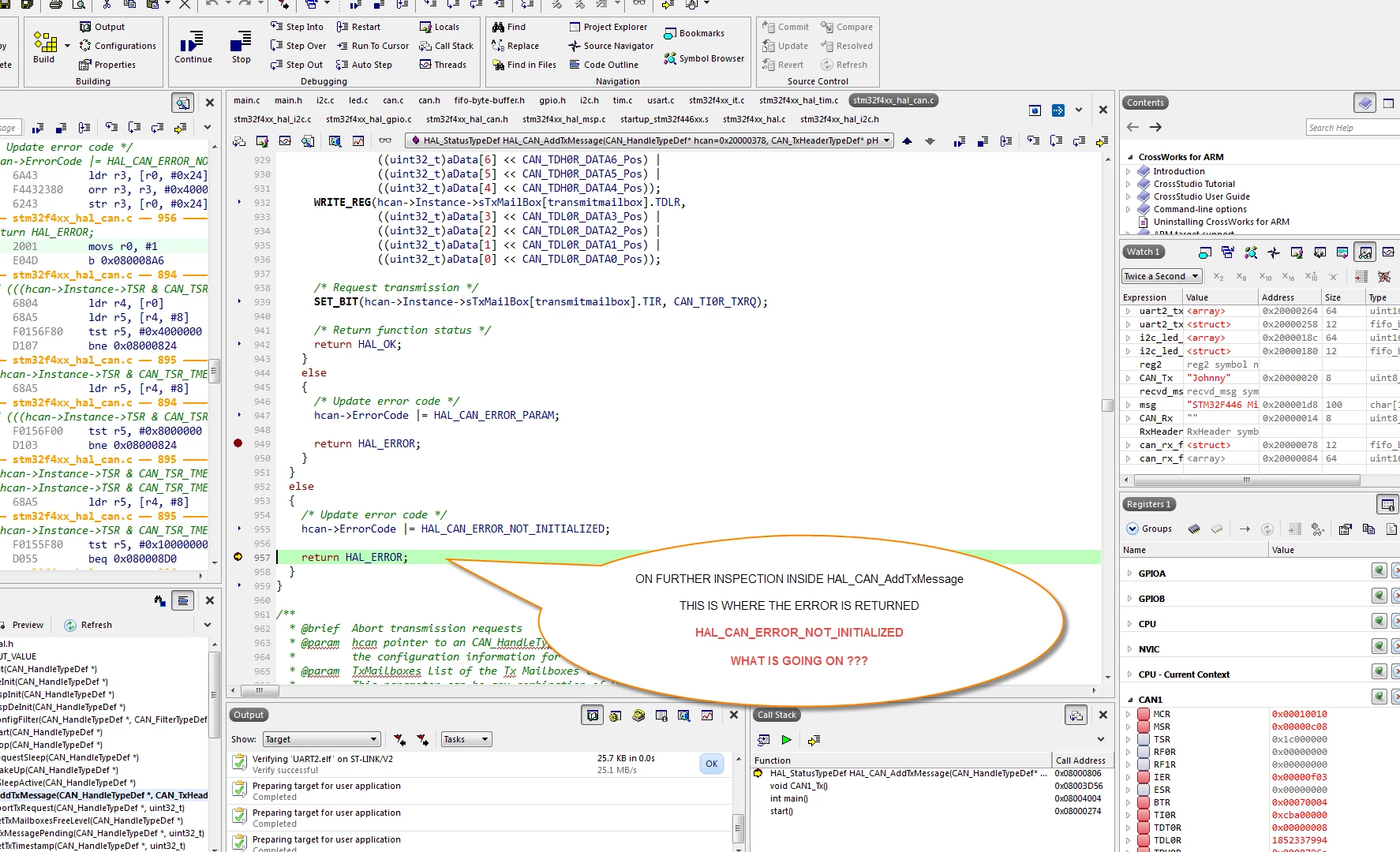

ON FURTHER TESTING .?????? ... WHAT IS GOING ON, the returned error is HAL_CAN_ERROR_NOT_INITIALIZED
it's already sent two/three messages and now it is saying it's not initialized
are these HAL APIs buggy or flawed ??
this error is both in loopback and normal mode, is it because it is in interrupt mode ?
