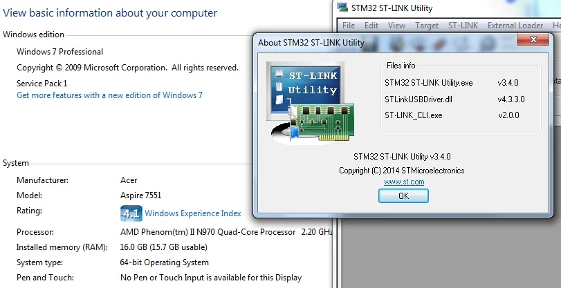

    Has anybody successfully installed this on a Win7 system?
    Yes, although it's unclear which version of the utility you're using. Used the ST-LINK on assorted Win7 x64 machines.
    Consider if you have AV software interfering with things, if you have administrative rights, and don't have any settings precluding the use of USB ports, or unsigned drivers, etc.

    This is a mirror of the v3.4 I have installed on my Win7 laptop
    https://drive.google.com/file/d/0B7OY5pub_GfIOHBCNnlJZlBhcTQ/view?usp=sharing

    A final follow-up to prior comments.
    After some arm twisting, I talked our MIS folks into
    dusabling my anti-virus.
    The installation worked like a hose!  We turned anti-virus
    back on and the utility runs.  Sorry it took me so long to
    try this and thanks to all who suggested this.
