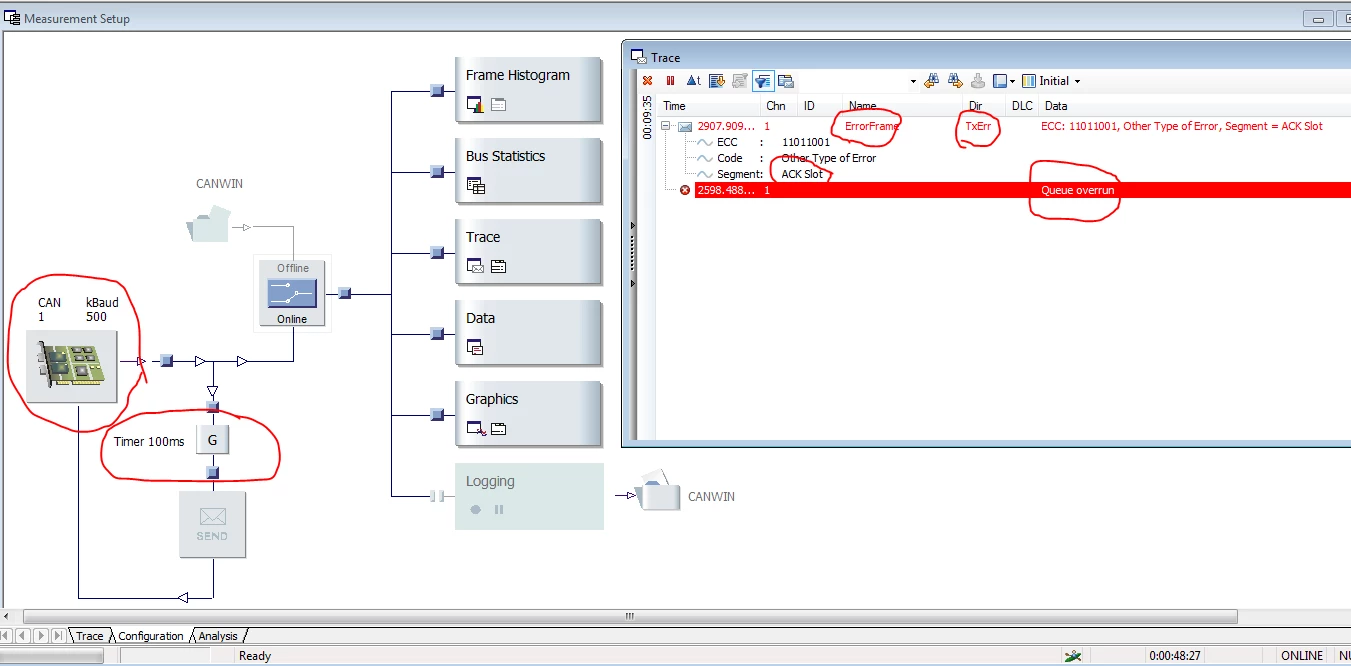

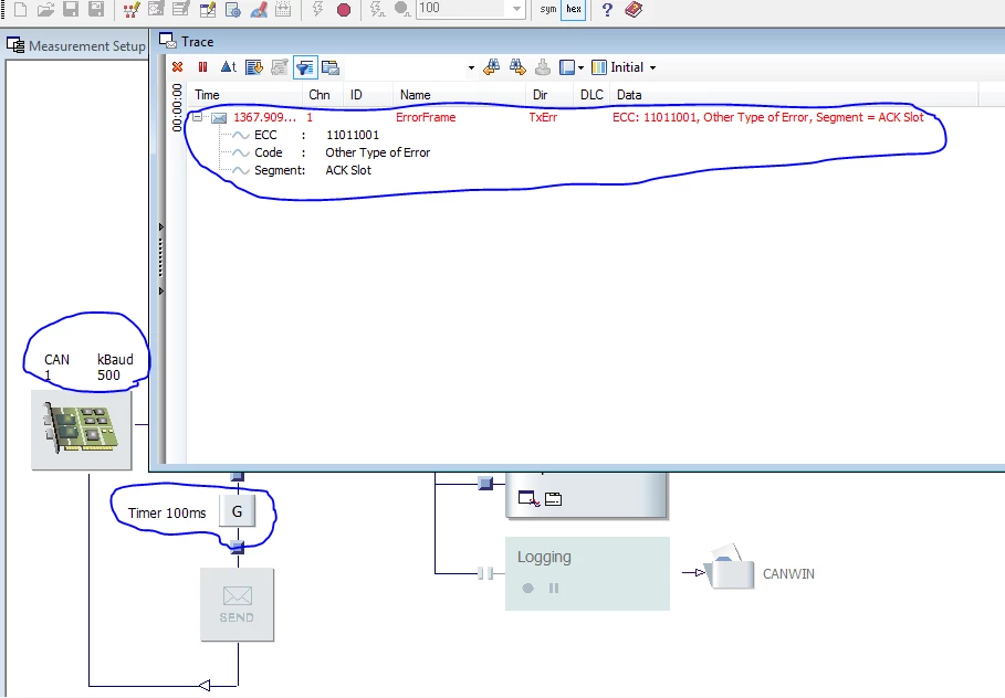

Hello All,
I have written a code for Transmission of frames from CAN-analyzer to STM32F429ZI board and back from board to CAN-Analyzer . But I am receiving only error frames in the CAN-analyzer. Even transmission also not happening. Please suggest me what is wrong in my code. I have pasted the code and attached CAN-analyzer result image for your convenience.
Thanking you.

    Hi kasar.sunil,
    I don't see a particular incoherence in your code.
    It may be interesting for you to make the test with other pins (if possible) like PA11 and PA12 as what is implemented in the example STM32F4xx_DSP_StdPeriph_Lib_V1.6.0\Project\STM32F4xx_StdPeriph_Examples\CAN\CAN_Networking.
    -Mayla-
    jpeacock
    October 1, 2015
    Posted on October 01, 2015 at 19:11
    Check the CAN_ESR register on the F429 to see if you have errors on the STM32 side.  You might want to add the CAN SCE interrupt.  What is the crystal frequency on your HSE oscillator, and are you sure the PLL is set correctly?
    You might try a lower speed first.  Do you know what the quanta settings on your analyzer are?
      Jack Peacock
