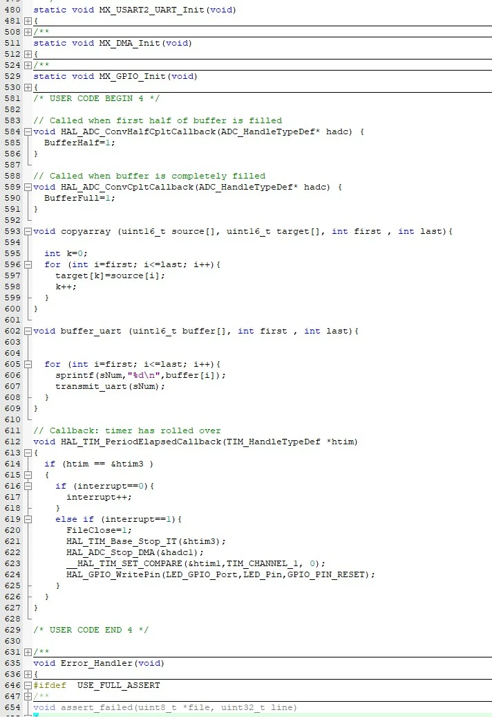

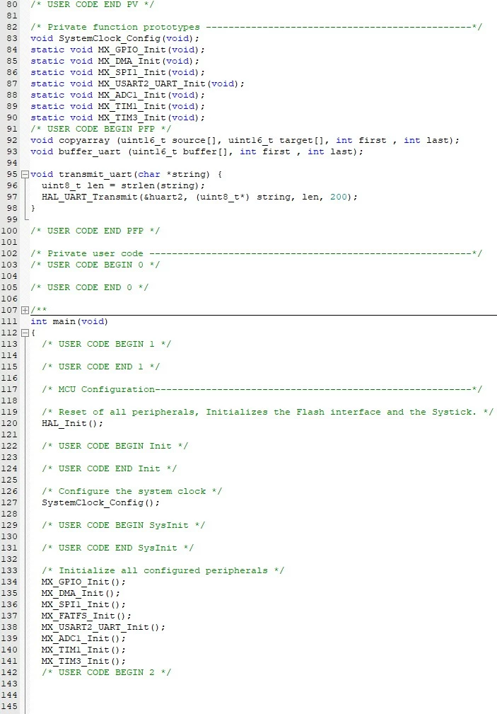

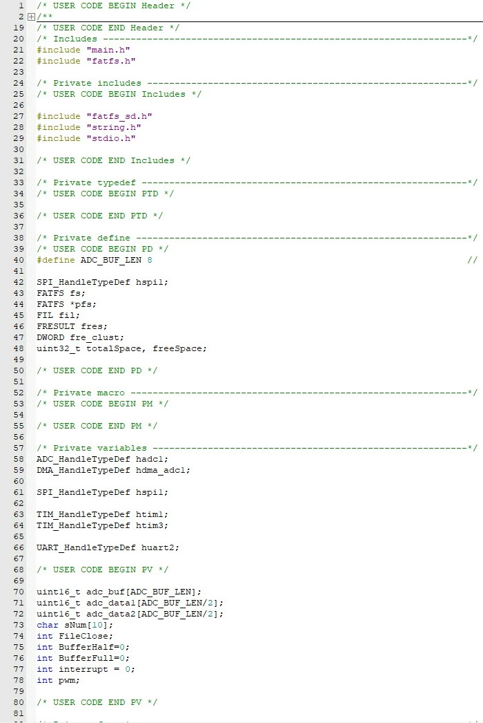

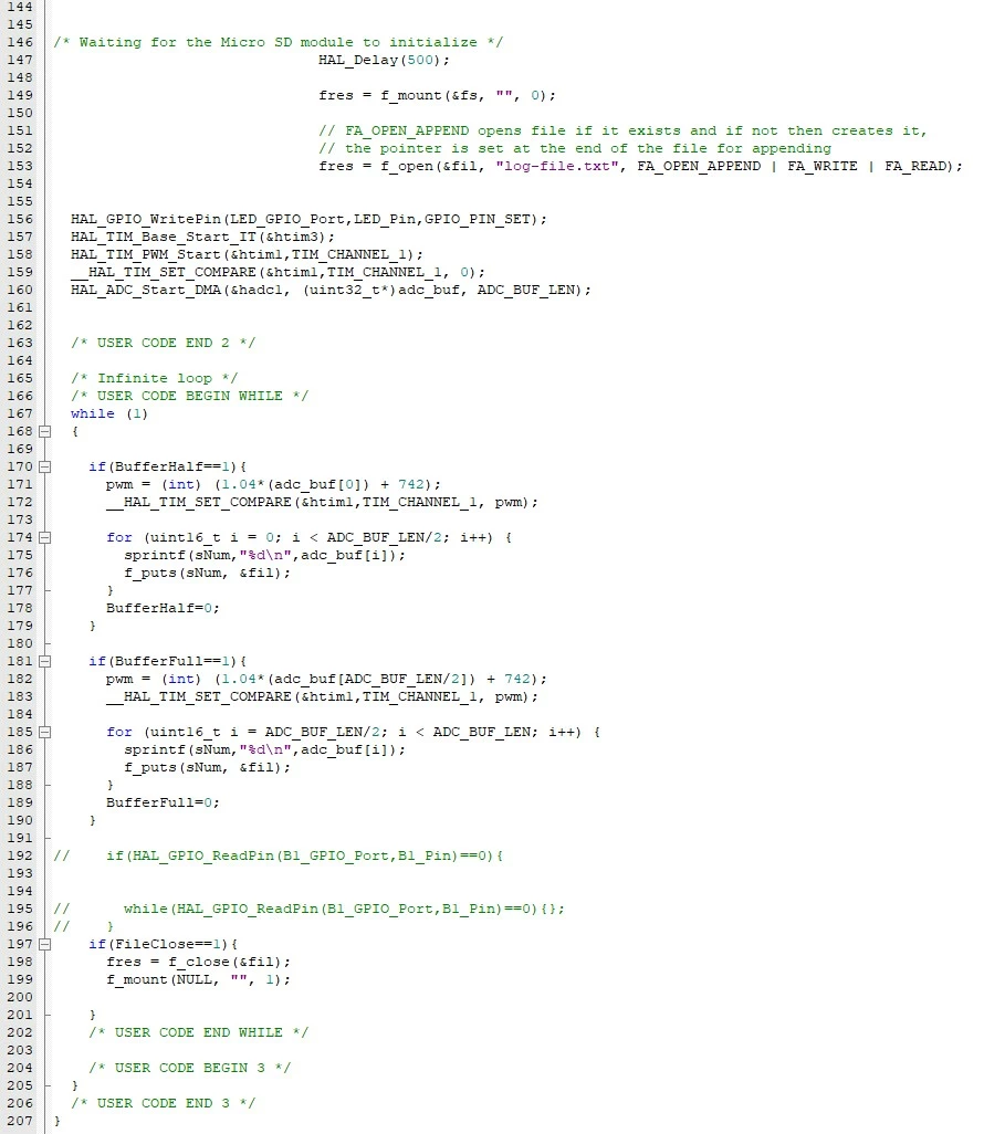

Thank you for answer. Yes, when I tried I used DMA and buffer. When half of the buffer was fulled, data sent to the sd card module with SPI protocol. But, when the half of the buffer data was sending to the sd card I lost the data. My code is below. Thanks in advance!

Maybe you problem is related to the known issue in CubeMX v 6.3.0 with DMA initialization (For more detail, please have a look at this post)
It will be interesting to share with us your update please.
