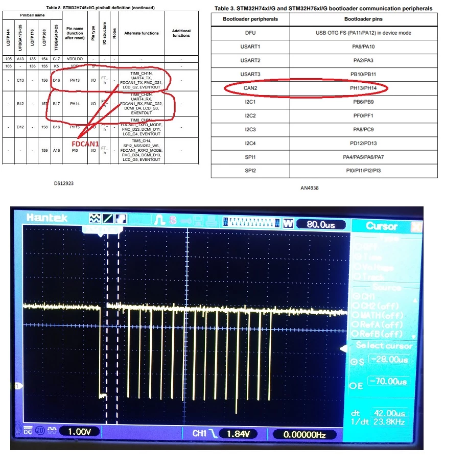

Using a Nucleo-H743 board, which unfortunately does not have a FD/CAN example
( https://github.com/STMicroelectronics/STM32CubeH7/tree/master/Projects/NUCLEO-H743ZI/Examples )
But following the code for similar chips, I do see an output on PD1. However it's only ONCE... with nothing attached to the bus, I'd expect retries. Also, if I add another message to the FIFO, it does not send it. The only way to get one output again, is to re-initialize the peripheral.

The only clue or error I can see is that the (24kbps) bitrate isn't what I'd expect (1Mbps) based on the FDCLK of 48Mhz.
The DS12923 document says the CAN BOOTLOADER PINS (PH13/Ph14) is FDCAN1, yet the AN4938 document says it is FDCAN2.
