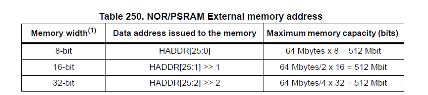

Hi
I could not able to understand a particular page in reference manual (FMC).. i have attched the page. Could anyone explain that.
 how the memroy capacity is 512  mb. it showld be 2^26 is 64 mb ?

    64MB -> 512Mb
    B(ytes) Upper case B
    b(its)    Lower case b
    There being 8 bits in a byte.

    ok clive. i got mixedup between two b..
