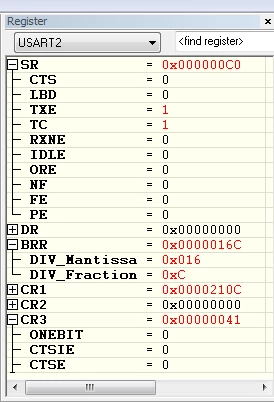

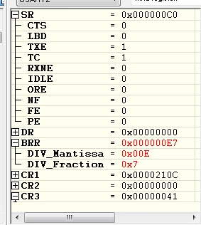

When the USART is  hot swapping,some datas will occur on TX RX pin;and the value of BRR register will be changed;the picture 1 shows the BRR before  hot swapping;and the picture 2 shows the BRR after  hot swapping.
Why this question happens?And what can I do to avoid this quetion?​

0693W000005B6ugQAC.pngthis is picture10693W000005B6ubQAC.pngthis is picture 2
The USART of STM32 is connected to another terminal with a network cable;when plugging the cable,some Interference  datas like"FF"will occur on the RX pin of STM32 ;then the value of BRR will be change 。
