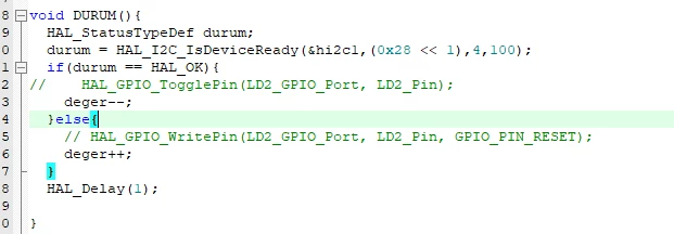

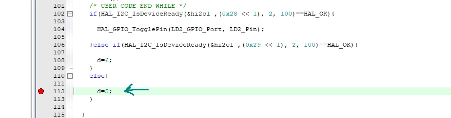

I wanted to see if the bno055 sensor is ready and set the PB8, PB9 pins as SDA, SCL. (my mcu = stm32f334r8)
connections
SDA_pin -> SDA pin sensor
SCL_pin -> SCL pin sensor
VCC -> VCC
GND -> GND
0693W00000aI7CEQA0.pngbut the variable is never HAL_OK
thanks for answer.

Hello @Hamdi Huntürk​ ,
Please make sure you are using the correct parameters for the communication :
  • Address (The default address is 0x29)
  • The frequency ( 400MHz max ) ..
Foued

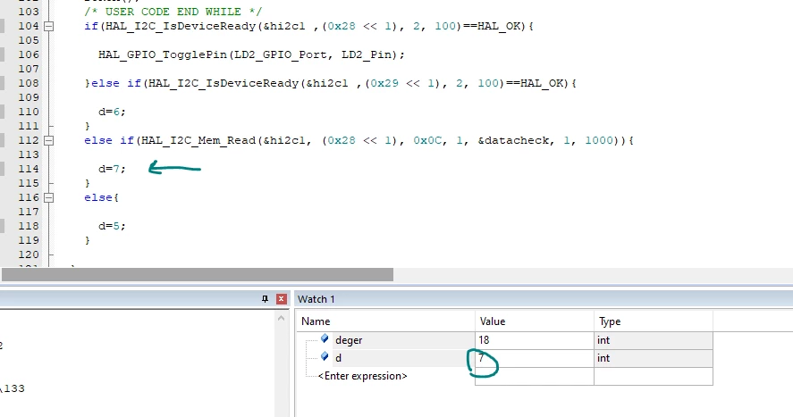

@KHALSI_Foued​  I checked the maximum speed and default value but same result0693W00000aI7jNQAS.png

Please check pin connection :
  • PB9 -> SDA pin sensor
  • PB8 -> SCL pin sensor
  • VCC -> 3.3V
  • GND -> GND
Because It's works (0x28<<1) with
HAL_I2C_Mem_Read()
Foued

actually it works this way but why didnt work HAL_I2C_IsDeviceReady function
