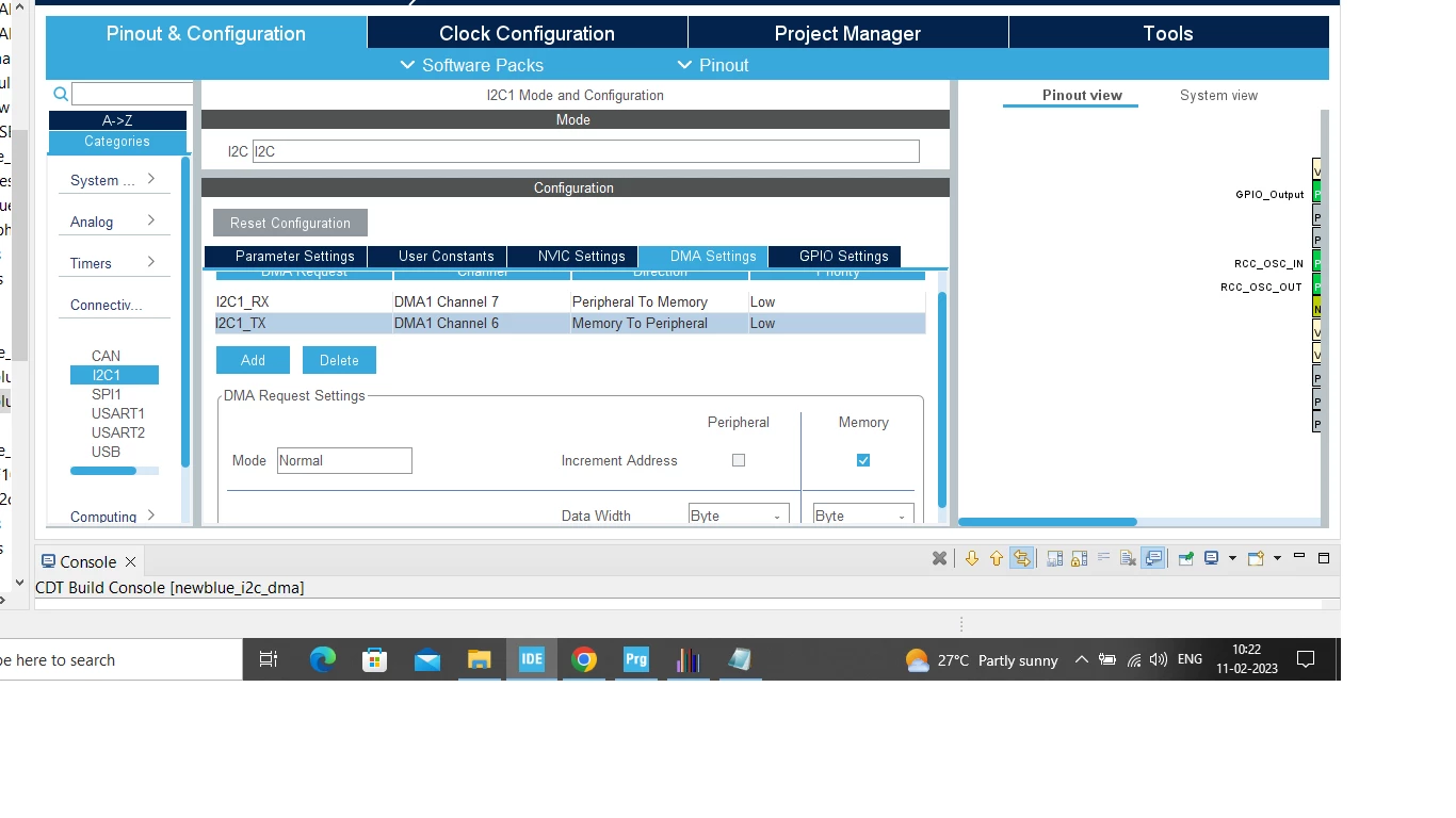

bh1750 sensor i2c poll method working fine but i2c DMA method not working with attached code . will DMA only transfer the value to global variable ?

i am able to getting result with i2c DMA with following .
if(HAL_I2C_Mem_Read_DMA(bh1750_i2c, BH1750_ADDRESS, BH1750_ADDRESS, 1, tmp, 2)!=HAL_OK
instead of
if(HAL_I2C_Master_Receive_DMA(bh1750_i2c, BH1750_ADDRESS, tmp, 2)!=HAL_OK)
i am did know why Master_Receive_DMA is not working and Mem_Read_DMA is working .
Bh1750 sensor having single register Master_Receive_DMA is passing only one time read address with read bit but Mem_Read_DMA sending one time read address with read bit and additionally sending same read address without read bit but it's working .may be some one explain
KnarfB
February 13, 2023
HAL_I2C_Master_Receive_DMA will immediately return, before the buffer is filled. So it makes no sense providing a stack local variable.
The clines afterward must belong to a completion handler, which is called after DMA was completed.
If you put them directly under HAL_I2C_Master_Receive_DMA, it may or may not work depending on timing, but this is principially wrong.
hth
