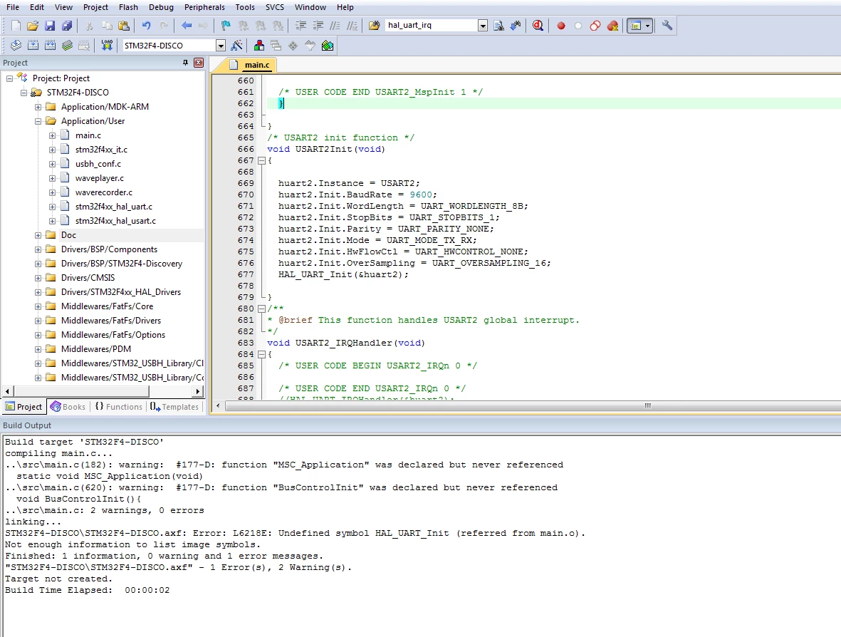

at this point i want to add an uart to send the ''song'' name to be played
i added the library stm32f4xx_hal_usart.c and stm32f4xx_hal_uart.c and header files(in any case )
and when i try to build it generate the error
''STM32F4-DISCO\STM32F4-DISCO.axf: Error: L6218E: Undefined symbol HAL_UART_Init (referred from main.o).''
because of the line 677 - see print atach
there is any point i'm missing?
i'm block at this, so i'll apreciate any help =)

    Make sure HAL_UART_MODULE_ENABLED is defined in your project

    i added a line to my main
    #define HAL_UART_MODULE_ENABLED
    still didnt get results...
    if i right click on HAL_UART_Init(&huart2); in void USART2Init(void) called from main and do ''go to definition of HAL_UART_Init'' it show up ''source browser: ' HAL_UART_Init' - undefined Definition/Reference!
    but if i do a search in current project it found on the stm32f4xx_hal_uart.c line 240

    I think it needs to be in the project's stm32f4xx_hal_conf.h , not main.c as it does no help there.

    great it work
    wasnt stm32f4xx_hal_conf.h ! i put it in stm32f4xx_hal_uart.c (i describe for someone with similar error)
    but analizing the files in stm32f4xx_hal_conf.h the code line
    /* #define HAL_UART_MODULE_ENABLED     */ is comented
