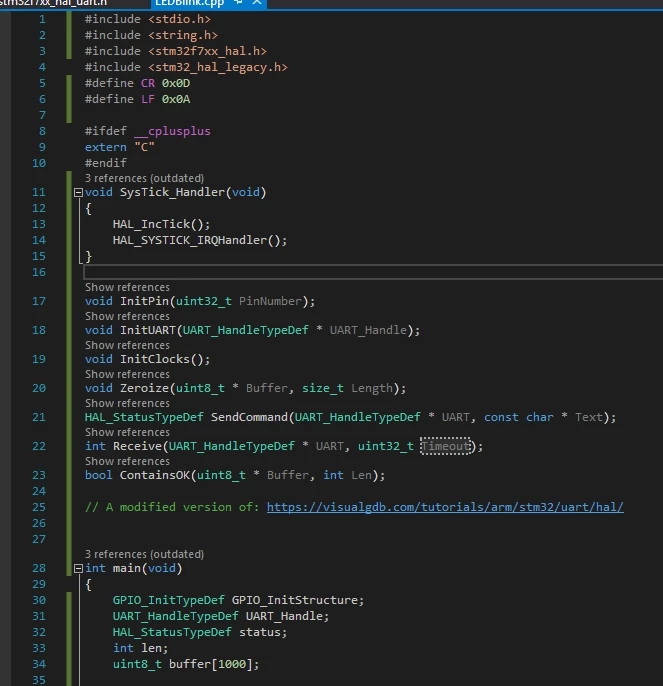

I've been playing around and refactoring a small test app for the STM32F769 DISCO board. The app runs fine and I retest after even the smallest code tweak.
What I'm seeing is that physical position of the function SysTick_Handler within the source code, impacts its run-time behavior!
For example this runs:

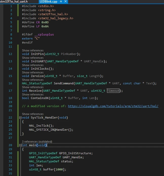

whereas this fails:

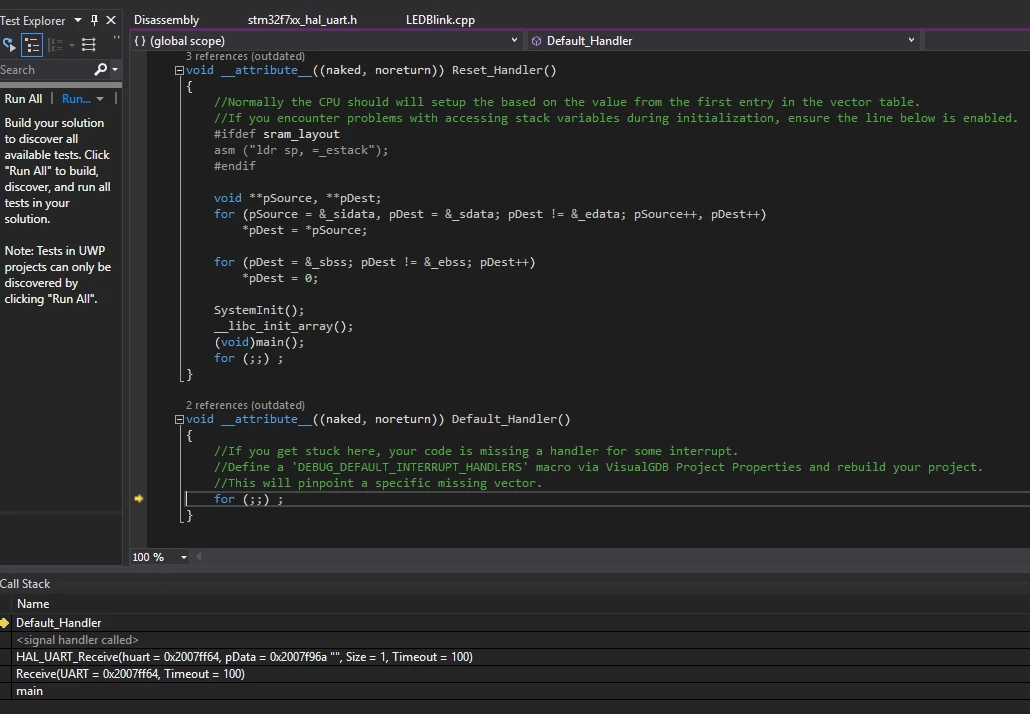

If I interrupt the failing version, I see this stack trace:
Now I've used C a great deal (Windows and interop with C#) but eased off about three years ago, I'm very new to C++ too. However I've developed compilers for pretty complex languages (compilers written in C in fact) and I've never seen or heard of this kind of sensitivity to the location of functions, I'm not aware of anything in either C or C++ languages that explains this.
 ...a short time later...
OK it's me, I'm a bozo - the extern "C" directive is required and was being applied or not applied as I moved the code body around! Declaring a prototype and ensuring it has extern "C" fixes it all!
