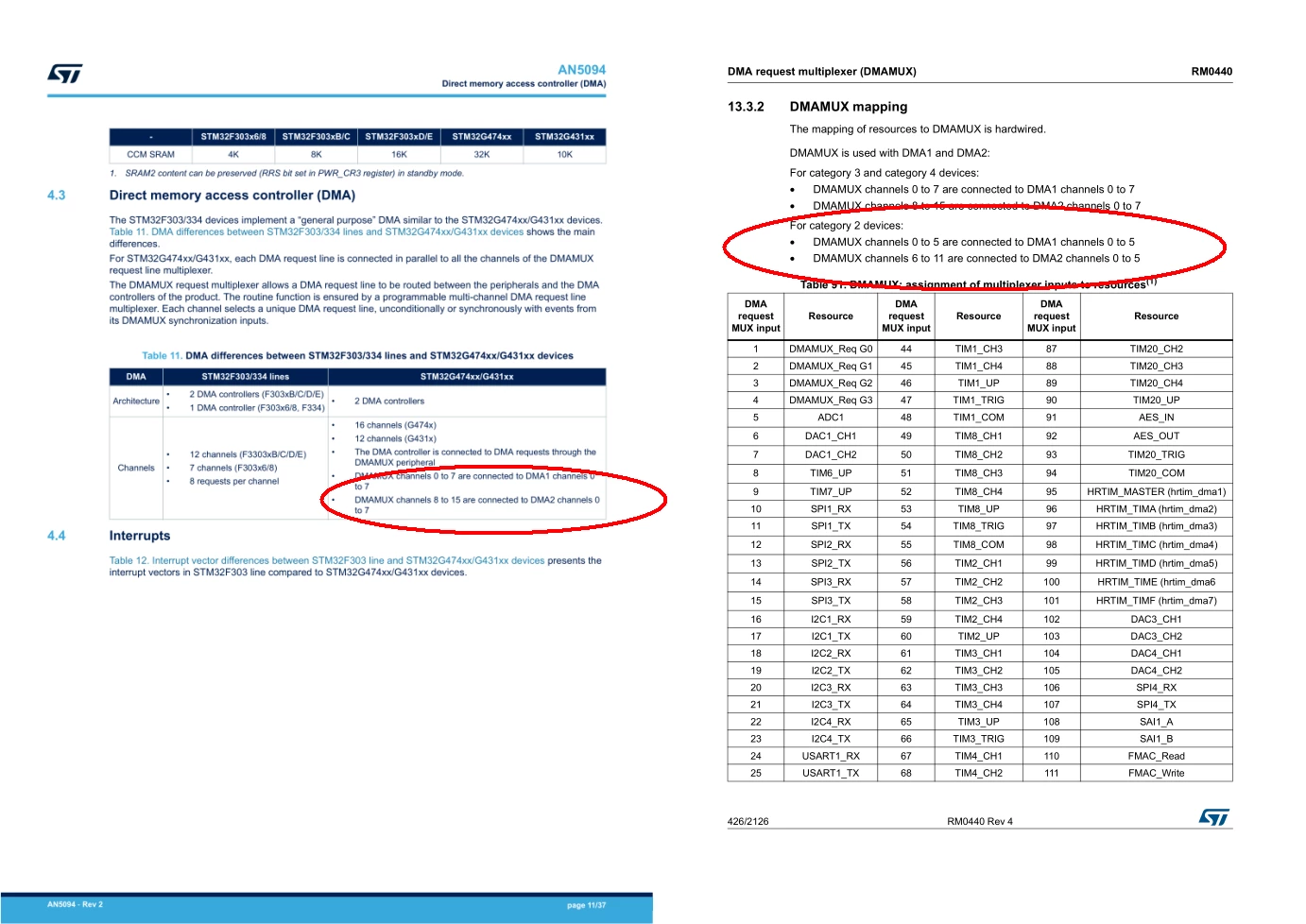

The waitstates table in 4.5.1 Performance versus Vcore ranges also does not reflect the current state of affairs.
https://community.st.com/s/question/0D53W000004JX9fSAG/stm32g474-flash-wait-states-at-170mhz-cpu-clock
hamdi.najoua
May 8, 2020
​Hi Jan,
You are totally right! The migration AN should be updated to consider the new G4 WS specification.
This will be considered in next AN5094 version.
Thanks for the input.
Regards,
Najoua.
