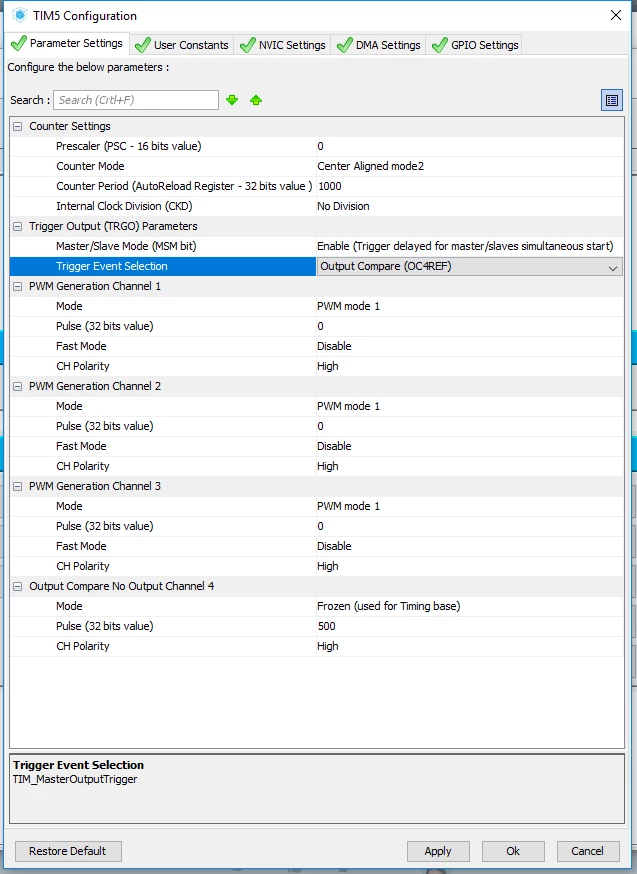

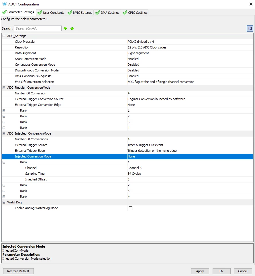

I have some trouble in implementing the trigger conversion for an ADC with a timer on an STM32F410CBU6 microcontroller. I'm using the HAL libraries and configured everything in CubeMX, but I never can trigger any measurement with my ADC.

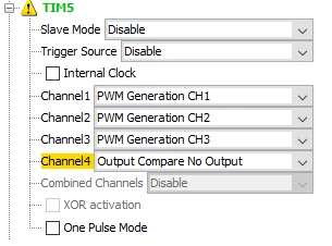

I have three PWM channels (PWM Generation CHx) configured and a fourth channel as Output Compare No Ouput, which should trigger a measurement at half the period. The settings in CubeMX are shown in the attachment. I really don't know what else I can do to start a measurement.
I initialize the timer like this:
HAL_TIM_PWM_Start(tim5,TIM_CHANNEL_1);
HAL_TIM_PWM_Start(tim5,TIM_CHANNEL_2);
HAL_TIM_PWM_Start(tim5,TIM_CHANNEL_3);
HAL_TIM_OC_Start(tim5,TIM_CHANNEL_4);
An the ADC is started like this:
HAL_ADCEx_MultiModeStart_DMA(adc1, (uint32_t*)adc_buffer, ADC_BUFFER_SIZE);
Any one an idea what I'm doing wrong here?
