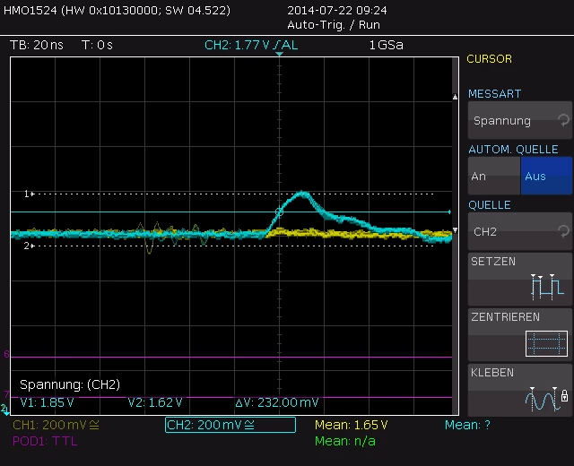

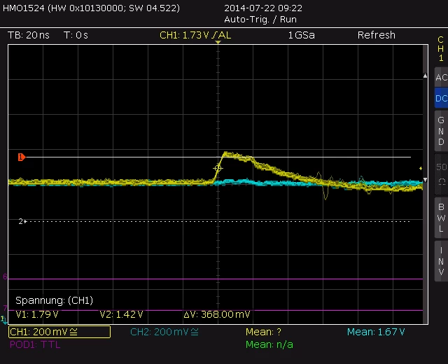

I am reading two analog voltages with ADC1 in triggered injection mode.
The voltage on the pin with injection rank 1 always has a peak at the injection event. Even when i change the ranks of my two channels, the one with rank 1 always has the peak.
Here are some Scopes:
CH1 (Yellow) is ADC_CHANNEL_8
CH2 (Cyan) is ADC_CHANNEL 15
Here ADC_CHANNEL_15 has rank 1:
Here ADC_CHANNEL_8 has rank 1:
Do you have any idea how i could fix this?
Thanks in advance!

Also, the first ADC channel always has more noise on it.

What you see is the charging process of the sampling capacitor of the ADC. As the two channels has almost the same voltage the capacitor is almost charged before the second conversion.
The noise measured in the first channel is most likely due to insufficient sampling time. Try to increase it in the corresponding SMPR register of the ADC.
