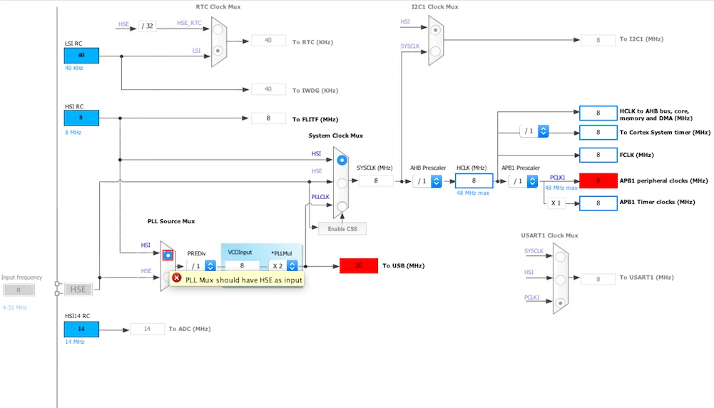

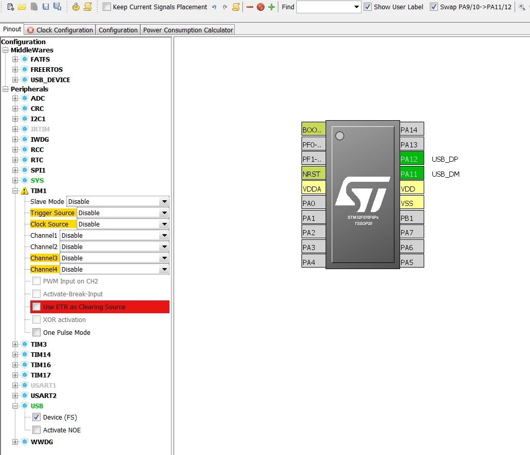

Hello i'm using CUBE 4.22 and i keep getting a conflict (see jpg bellow). when i click the checkbox USB->Device (FS), the TIM1 says ''!'' and shows several conflicts. and when i click on the Clock Configuration tab, the clock screen appears and i see a dialog box that says ''do you want to run the automatic clock issues solver?''. i click ''yes'' and then it says ''cannot find solution for some constraints''.
is there a way to resolve this problem? thanx

    >Is there a way to resolve this problem?
    Its telling you that PLL MUX needs HSE not HSI. You need an external crystal/oscillator if you want to use USB.

    Posted on July 19, 2017 at 01:49
    i don't understand. i specifically chose the 70xx chips because they're not supposed to need a crystal. the ST website says that
    'The STM32F0x0... comes with a full set of performing peripherals, such as fast 12-bit ADC, advanced and flexible timers, and recently added crystal-less USB.'
    but the data sheet for STM32F070xB and STM32F070x6 says that 'the clock source must use an HSE crystal oscillator'
    but i have a nucleo board, the NUCLEO-F070RB, and programmed it with USB and it doesn't have a crystal. and the USB interface did work well.
    so WTF? i don't have space on my PCB for a crystal.
    and, i recall, i used CUBE to generate the code for the nucleo board. this doesn't make sense.
    and when i go back to CUBE and click the Clock Configuration tab, the HSE option is greyed out, i can't select it.
    thanx :)
    OK (5 minutes later) i enabled the RCC with ceramic resonator and selected HSE. but the problem remains. i can't use a crystal and CUBE won't cooperate.
